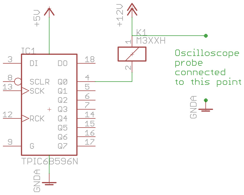

I'm working on a project with many (literally over 120) TPIC6B595 shift registers, each driving 12 V solenoids. The project is in the prototyping phase, and now I've experienced a strange behaviour. Please, help me to find a solution to this problem.
The usual current of the solenoid is 125 mA, which is close to the boundary for the shift register. The IC is connected as usual, the solenoid is connected directly to the chip, as well as to a +12 V source. Both grounds common (5 V logic and 12 V drive). At start-up, everything goes fine, until the first activation of the solenoid. It closes perfectly with a current draw of about 125 mA. This state remans for two cycles (500 ms each, one division on the picture below), then should go of. But it doesn't. It remains closed and draws 35-40 mA.
The schematics shows the measuring setup.
External link to the schematics picture.
This one representing the actual voltage change during the procedure:
External link to the oscilloscope screen capture.

Why are you not using a kickback diode?
Are you using decoupling on Vcc.
  1. Tie SCLR to +5
  2. Tie G to Gnd.
  3. Add 0.1uF cap from +5 to Gnd, close to the chip as you can.
  4. Add diode across the coil, cathode to 12V, anode to the shift register side
    1N5817 Diode Schottky 1A 20V
May be the diode is optional. From the datasheet:
The device contains a built-in
voltage clamp on the outputs for inductive
transient protection.
The "G" pin as marked on the OP's schematic is actually "NOT G"
A 50 volt clamp. :wink:

Funny, that solenoid looks like it would draw more than 125 ma at 12V.
What is the resistance of the coil?
Edit
If your scope is looking at the solenoid plus supply to GND, you have a serious problem with the solenoid power supply.
Why do you measure the +12volt (pin1 of the solenoid) point.
You should be measuring Q0 (pin2 of the solenoid).
That should go zero when the solenoid is active, and return to +12volt after the 50volt kickback spike.
If that +12volt supply doesn't stay 12volt all the time, there is someting wrong with the 12volt supply.

  1. Yes. The oscilloscope probe is connected to the positive side of the solenoid and to common ground. The result is the same with some math difference on the opposite side.

The solenoid draws 125 mA when connected to 12 V. At this point, 10,55 V measured on the pins.
I do not have any specs for the solenoid, and as far as I know, it's a bit more complicated to calculate the resistance than making a simple measurement with a multimeter. Above data may help a bit.
Yes, it's possible. By the way, I'm going to fix it.
If this scope image is looking from +12v to GND, there is simply something wrong with the power supply.
It should remain at 12 volts wether the solonoid is picked or not!
Just measure the coil resistance with an ohm meter.

It was just one way to make measurements. Today I've made more with both pins measured with an individual probe. (Yellow is on the positive side, light blue is on the negative side, dark blue is a Math with lightblue (minus) yellow).
Yes, you're right. But it's not true unfortunately. It doesn't go back to the normal level.
In short (see the picture, sorry for the quality, screenshot didn't work):
negative side: normal state: +12.6 V, activated state: around 1.1 V, deactivated state: 8.2 V.
positive side: normal state: +12,6 V, activated state: around 11.5 V, deactivated state: 3.5 V.

86.8 Ohm.
