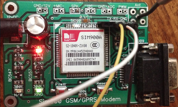

Finally, I picked up SIM900A - some local module. I am trying to sms..
2 days have passed by and I am still struggling to send sms with code (pls. ref below):

I understand status 2 stands for failure. The GSM module is couple to Arduino Uno (Flash 32 Kb).
Can someone please guide me on the reason of failure/ the changes I need to make...Meanwhile I will continue googling.
P.S.: FYR, attached herewith is my GSM module snapshot.

P.S.: When I call the phone#(SIM) on the GSM module, I hear the ring (simultaneously, the "RING" LED blinks on module) - that means the the number is dialling.
Where could I be going wrong.
Regards
Have you tried the earlier part of the page, just testing communication with the SIM900 with SerialRelay? There's no point trying to run a program if you can't communicate.
You're right Dannable; I skipped over some steps.
Now I see that GPRS.available() fails; GPRS is a SoftwareSerial object. I do have a GSM GPRS added in libraries folder. Pin connections were mentioned earlier: Rx-Tx, Tx-Rx, Gnd-Gnd & external supply 12v DC.
So, I'm stuck clueless. Indicators on GSM modules seem to be throwing right signals - network led blinks every 3 secs; ring led glows when I call the no.
Where am I be going wrong.

First, if you are using more than one instance of SoftwareSerial you could have problems. But we'll leave that for now.
All the functions you have described (call indicator, led flashing) indicates that the SIM900A is connecting to the cell phone network. The problem is that you can't communicate with the SIM900A.
Disconnect everything from the Arduino. Upload the following sketch:

Now connect SIM900A Rx to 8 and SIM900A Tx to 7. And ground to ground of course. And the USB cable from your computer. Apply power. Open serial monitor and set the baud rate to 19200.
Type AT and click 'Send'. If you don't get any response at all then swap Rx and Tx over.
Ok Dannable,
So, finally I am getting the AT and OK on serial window. I recognized that my Rx, Tx were connected to Pin 0, 1 Tx, Rx of Uno (and, an Adafruit was fixed atop Uno).
Moving ahead to next program on Seeedstudio page (sent by you), I change the baud rate to 9600. It runs and I see the "Ready.." message.

If I get it correctly, yes I did too. I sent message two separate messages: #a1 and #a0 (there were no quotes around #a1 message) to the SIM on GSMmodule.
Not seeing any LED, I took out the SIM in some time and put it on handset and yes, I did see the messages - they loaded once I put sim in the Handset.
In addition, I tried send message too, without any result...
Regards
Previously you said that you got had the net led blinking slowly, indicating that it had connected to the network. Was that the same on this occasion?
Just to ensure that all settings are fine, I ran a brief diagonistics:
  1. Checked that N/W is locked.
  2. Made a call to module's SIM and saw the ring LED glow
  3. Finally, pushed reset button on module and waited for GSM module to lock again i.e. N/w led blinking at 3secs frequency.

The code seems to be minimal. And, I had run the diagonistics (supposedly) successfully at the beginning. So puzzled about failure.
Regards
How long does it take until you get a 3 second blink from powering up?
about 5 seconds..it blinks at faster rate till then.
I replaced earlier SIM with another one. No luck yet...
