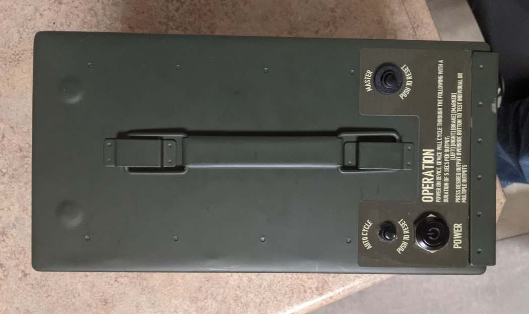

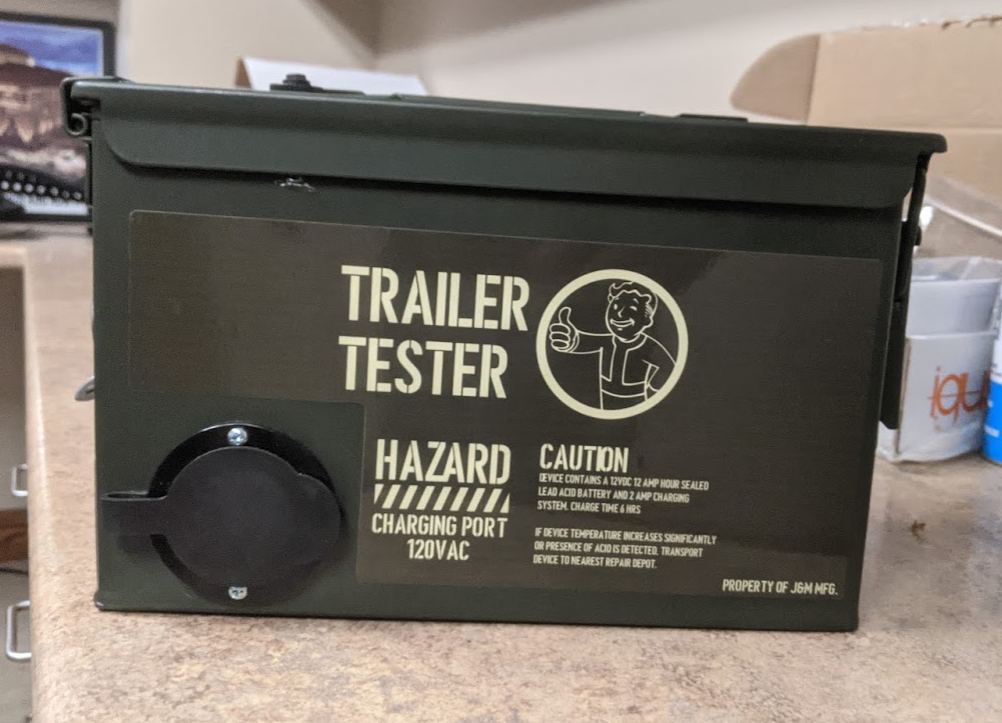

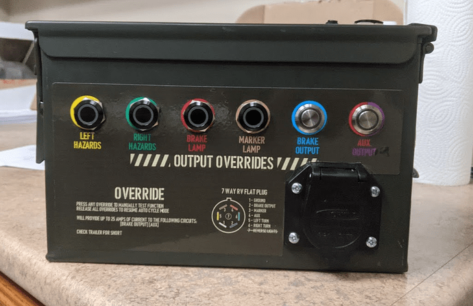

The completed project!
We have a large format latex printer that I made the decals on. There is a lot I want to do to simplify the hardware internally. I'm using an off the shelf 4 ch relay board and a couple of 40 amp relays for the high power outputs. Its powered by a 12ahr SLA battery. And there is enough hot glue inside to fund a small hobby store owner's kid college.
Ideally I would like to get to the level of designing my own PCB with a SLA charging circuit, 13.8VDC to 5VDC, four 10 amp relays and two 40 amp relays for the Electric Brake and Accessory outputs. with the common connected to the battery.
But it works and its solid. Hopefully our production team won't beat it up too bad.
Thanks for all the input guys!
More Pics
Looks robust. Nicely done.
Very impressive...
I like the low profile button/switch on top, to protect them.
I have also used those LED illuminated press buttons on the side, they really help to polish a project off.
