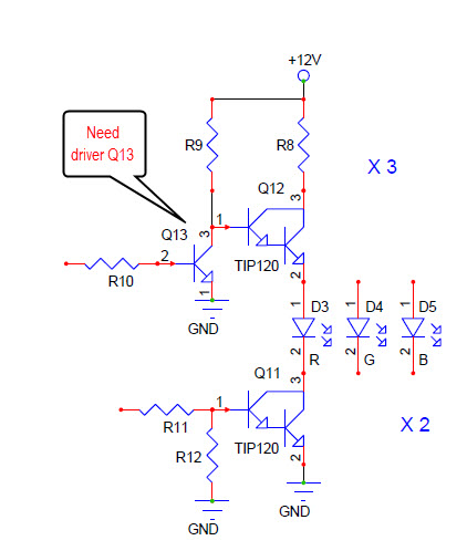

See two images below:

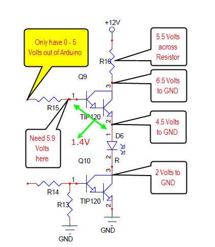

Are you saying that just increasing the voltage to 12V would not work? Or, are those diagrams explaining how the top TIP120s could be used to regulate the the LED current like Vaclav explained?
Where are you getting the 5.5V drop value over the resistor? Edit: Nevermind, I see you wrote above that 12V - 2V(TIP120) - 2.5V(LED) - 2V(TIP120) = 5.5V (across the resistor).
Also, I measured the actual voltage drop across one of the bottom TIP120s (the ones that control on/off) and it is only 0.6V. Is this because the overall voltage (5V) is inadequate, so 0.6V is all that's left by the time it gets to the second TIP120?

This does depend on other voltages, if the transistor is saturated and the amount of current that is flowing through the transistor.
Worst case (assumption is) 2-6 volts. If you are measuring .6Vce at a current of 200mA then you have to recalculate your series resistor using this voltage.
It is always best to use your voltmeter to confirm any assumptions.
You have two problems the first one I mentioned earlier, when you were using a 5 volt supply and therefore not enough to drive the LEDs.
The second one, where the Arduino output isn't going to be sufficient to turn on the top transistor as it's Base needs 5.9 volts. The Arduino can only output 5 volts maximum (this exists no matter what the power supply voltage is).
I still don't understand why this now wouldn't work without an additional transistor driving the upper TIP120 if the voltage was increased to 12V.
You will need the driver transistor on the top TIP120 (as in 2nd image).
If I were you I would hook up a test circuit as in the 2nd image for one LED to confirm it will work as I have said, then proceed with your project.

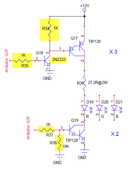

If it was me, I would either use MOS FETs or, in your design, change the top transistor to a TIP127(PNP) with TIP120(NPN) in the bottom (I have not shown a image of this option as of yet).

Could the driver transistor just be something small like a 2N2222? I'm assuming R9 and R10 in your drawings would still be something like a 1K resistor, but with the driver transistor, it would supply 12V through the 1K resistor to the TIP120 whenever the driver transistor is off, correct?
How would changing to a TIP127 for the top transistor change things? Obviously I would have to invert my PWM signal (0% would be full on, 100% would be full off.) But, wouldn't I need the same 5.9 volts supplied to the base in order to turn off the transistor? Or, does the TIP127 not have the same voltage drop when it's non-saturated and allowing current flow that a TIP120 has when it's saturated, allowing me to keep my original 5V design?
TIP127 option
Sorry, the PNP at the top should be a TIP127 not a TIP129.
Ok, so you're just inverting the signal again using the TIP127 so I don't have to invert it in the software.
Is there a reason you moved the current limiting resistor to after the TIP127?
Last, what is the purpose of R38, the 10K resistor?
Thanks.
I moved the LED resistor because in switching applications you want a common emitter configuration (no resistor between the emitter and the power supply +12V as in the TIP127, and the GND(0V) in the TIP120).
The purpose of the 10K resistor is to make sure the TIP120 is turned off during power up, when the Arduino is in a Hi Z state (all pins in the IINPUT mode).

A LOW output from the Arduino to the 2N2222 turns it OFF. The 12V at it's collector turns the TIP127 OFF.
A LOW output from the Arduino to the TIP120 will turn off the TIP120.
