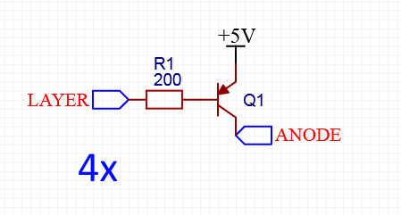

My confusion is how to control the 4 anode layers. I have seen many people using NPN BJT transistors, but they tend to have common cathode layers instead of anode - which leads me to believe that I need 4 PNP transistors? Is that logic correct?
My understanding is that at any given time, only one layer will ever be "lit" at once, meaning a maximum of 16 LEDs will be on. If each LED has a forward current of 20mA, then at most I need a transistor that can handle 16 * 20mA = 320mA at once. Assuming I was right about needing a PNP transistor, would a 2N2907 PNP transistor be fine? It can handle 600mA.
If that is sufficient, how do I go about connecting it in my schematic? I'm assuming it would be placed somewhere in here:
Please be gentle, I'm doing the best I can to learn this stuff.

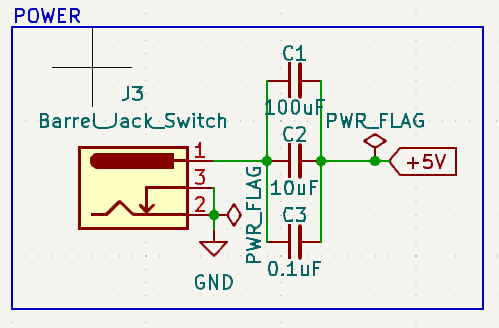

try always to not create a short circuit
switch
Is that better? Thank you.
yes
still short circuit (what is actually PWR_FLAG ?)
should be so:
and not forget current limiting resistor in serie to eich single LED.
EDIT: nevermind, you're faster than I am, haha
I'm learning KiCad and I think PWR_FLAG is something you add in to let the rule checker know that that is a power source. I'm following a video tutorial and this was the solution mentioned in it.
I'll be honest, when it comes to the power, I'm also a bit confused. I want to power this thing with an external 5V wall wart, and I believe that's the correct connector for it. To fix the short, would I need to connect the capacitors to the GND as well?
Thank you very much for this - this is very helpful for me!
i see, then it is not short circuit, but broken circuit, because external 5V comes not thru capacitors

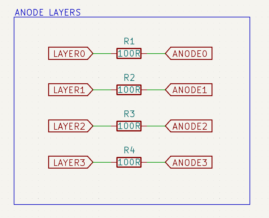

For the current limiting resistors -- I would need one per column? (so 16 total) For some reason I thought one per layer would be enough. It's so hard to gauge the quality of Instructable pages. :frowning:
So this is what it looks like now (just for anyone else who might be confused):

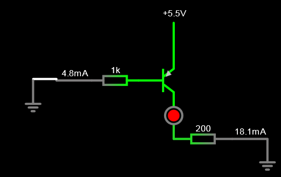

Quick question: how did you get a value of 200 for the resistor?

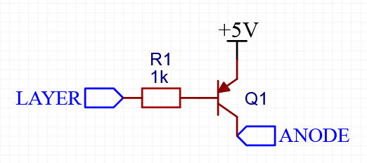

it will be calculated: (5v - 0.6V) / 0.02A = 220 Ohm
And the 0.6v ... is that a voltage drop? I apologize for the rudimentary questions -- electronics has never been my forte. :frowning:
a base-emitter voltage drop. i suppose it is 0.6V.
you can take 1k resistor.
If you use only one resistor per layer, you will need to multiplex the cube column-by-column. If you try to multiplex it layer-by-layer, there will be a problem because when only one led is lit on the layer, it will be much brighter than when all 16 are lit. This is because however many LEDs on the layer are lit, they will all have to share the current passing through that one resistor.
If you multiplex column-by-column, each led can be on for a maximum of 1/16th or 6.25% of the time. If the current flowing through the led when it is on is 20mA, then the average current will be 20 x 1/16 = 1.25mA.
If you multiplex layer-by-layer, each led can be on for a maximum of 1/4 or 25% of the time. The average current would be 20 x 1/4 = 5mA.
The average current flowing though the LEDs determines how bright they appear.
The suggested TPIC6B595 chip will not prevent that, or make it easier.
The suggested TPIC chip will not change the number of components required for your cube.
Here is a question for you: what is the maximum current that a 74hc595 chip can source or sink, across all its 8 output pins simultaneously? How will this limit affect your design? Answering this question may help you understand why the TPIC chip was suggested as an alternative.
