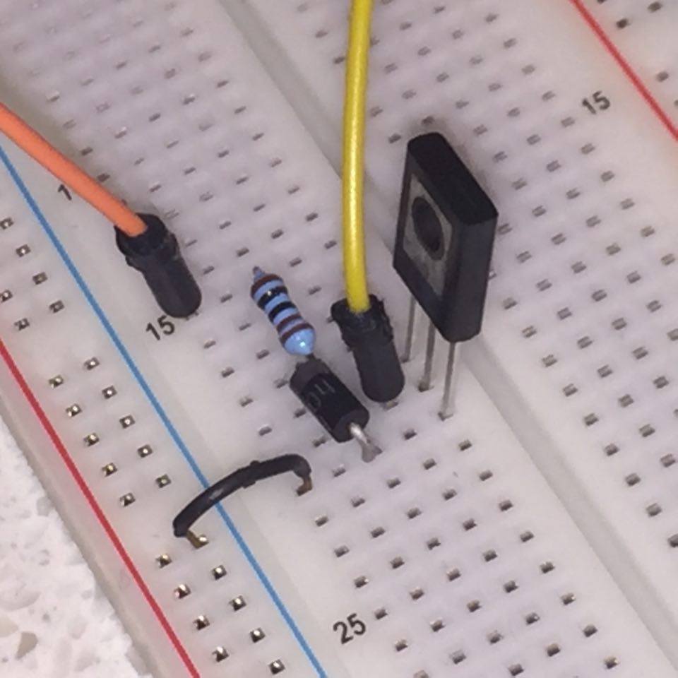

I have been learning by experimentation and reading documentation, but I am hitting a wall where I cannot understand why is my transistor heating up so fast to very high temperatures melting the plastic of the breadless board pins.
I am trying to control the motor speed by a sonar sensor the closer the obstacle is the slower the motor will spin.
I have attached the schematic the only difference is the 9V battery is an AC adapter outputting 12v and 2A

In the photo, it's not possible to see which way round you have the BD681.
If it's the same as in the Fritzing diagram, you have it wired incorrectly.
When looking at the transistor from the front, the pins (left to right) are:-
E C B
Which means that you have the base connected to ground, and you're driving the emitter. ie It's backwards.
Again, that's assuming the front of the real transistor is where the flat side is in the Fritzing diagram.

That transistor might have a saturation voltage of ~1volt with a 220ohm base resistor (can't see the real value).
Heat generated depends on motor current.
0.5A (0.5watt) might just be ok without heatsink.
Anything more and the transistor will get very hot.
The diode goes across the motor (cathode to +12volt), not across the transistor.

@OldSteve I have attached a close up picture of the setup as the Fritzing doesn't reflect truly what I am doing ,I will try to use the schematic view next time.
That's why I don't like Fritzing. :slight_smile:
Well the transistor is connected correctly, but as mentioned by Wawa, the diode should be across the motor. Effectively, the transistor collector to motor +V.
Sounds like you need a heatsink, to me.
The transistor can handle up to 4A continuous, but "TC=25°C".
ie You have to keep it cool enough.
Sorry for being such a noob, would you kindly explain what do you mean by the diode should be across the motor. Effectively, the transistor collector to motor +V.
Should I rotate the diode [vertically rather than horizontally] and put it between the transistor collector and the motor +V? I just thought to double check before doing any damage to any of the parts.

The diode's anode connected to the transistor's collector, (negative side of the motor), and the diode's cathode connected to the +ve motor supply, (positive side of the motor).

@OldSteve I have attached the new connection of the diode, would you kindly confirm if I have it the right way this time, I am not turning anything on just in case I got it wrong, I don't lose any of the parts due to back EMF.
You have it backwards. Just turn it the other way around.
The cathode is the end with the stripe. The cathode should be connected to the positive supply.
(As you have it now, the diode will short out the motor, only allowing it to receive 0.6V.)
Edit: I see that you still don't have a heatsink fitted. You'll need one. That's why your transistor is overheating.

is the diode getting warm? seems like it would just pass power when the motor has power, adding to the total load on the transistor.
Spidie, the idea is the diode blocks voltage under normal use. and if the motor were to run all the time, it would be totally unnecessary.
the diode is a safety valve that only acts when things are shut down and if there is a spike, it will give it a path, other than your chips.
the line (blocking) should be on the 5v side, not the ground side.
turn it around and see how hot the transistor gets.
use a small screw and washer or aluminum heat sink from something to add mass AFTER you test it with the diode in the correct way.
