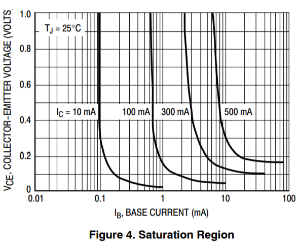

For reference let's look into a datasheet of NPN BC337 already mentioned in this discussion (link in post #21). There is "Saturation Region" figure:
You can get more information about the saturation characteristics from it. For example for 100mA collector current the V_CE is quickly decreasing with increasing base current until about 2mA (Ic/Ib = 50). For higher base current the V_CE is decreasing only slightly - probably not worth the increased base current and surely nothing that will cause a "scorching hot transistor". For higher collector current it is a bit worse - you need about 20mA base current for 500mA collector current - still gain of 25. And those numbers are probably for the "poorest" -16 selection. The "better" -25 and -40 selections should have better results according the Nexperia's more detailed datasheet. If interested, study Figures 10-12 closely.
I believe the Ic/Ib = 10 value is for historical reasons - transistor is considered "in saturation" when Ic/Ib = 10. But this does not mean you MUST use this ratio to get optimal results. Old transistors probably really needed such high base current. But as you can see it is not absolutely necessary with "modern" transistors, exactly as HallasT have said.
Also note the numbers are @25°C. Since too low base current -> hot transistor -> better gain -> lesser base current needed, the temperature rise is self-limiting for reasonably low base currents.
Since theory and comparing numbers from datasheets may be misleading I did a quick and dirty real life test. I connected the collector of a BC337-40 to a constant current source of 126mA, varied the base current and measured V_CE. There are results:
Ib -> V_CE
12 mA -> 60mV
3.6 mA -> 80mV
1 mA -> 140mV
0.4mA -> more than 1 V (limited not to damage the transistor)
You see that at 1mA base current, less 1% of collector current, the voltage drop is still reasonable - but you cannot go much lower.
