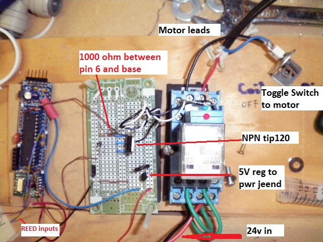

I have made a few successful projects now using TIP120/PWM pin to control things...I've got a 1000 ohm resistor between the pwm and the base.
I'm powering the Jeenode with a 78L05...I put a pair of diodes between the 24V supply and the input pin just to give a bit of voltage drop from the 24 volts (although it is rated to 35 volts). Measure 4.9 volts out to the jeenode.

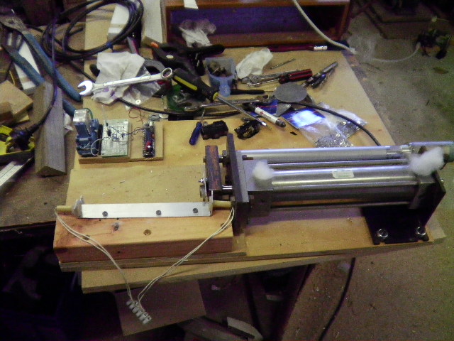

I'm at a loss...any advice or suggestions on how to debug would be great. Attached are my sketch and a photo of my "driver" and homemade pump (using a stainless steel pneumatic ram, check valves not yet installed).

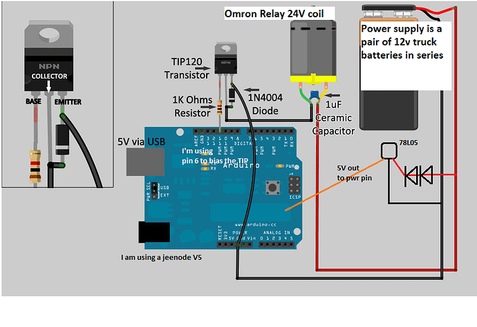

I’ve done my best with the wiring diagrams. The arduino/TIP120 was lifted from http://www.instructables.com/id/Use-Arduino-with-TIP120-transistor-to-control-moto/
Which is where I learned to use transistors to switch relays.
The polarity reversing cross wiring diagram is from forum.arduino.cc/index.php?topic=63783.0
Lefty’s instructions were spot on and it worked the first time.

You should have a commutation diode wired across the motor , at the motor with leads as short as possible
I mean the relay of course , what makes you so sure ther is a diode inside ?
Also mounting power components on a bread board is not a good idea.
Show a better picture of your circuit not someon elses.

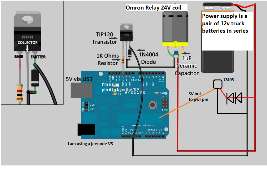

Please, please, can you please post a copy of your circuit, in CAD or a picture of a hand drawn circuit in jpg, png or pdf?
NOT a fritzy diag.
Hand drawn is easiest.

There should be one though across the supply leads close to the contactor
It appears to be a big ask to use a 78L05 from 24v via a couple of diodes.
They are only rated at 100mA and I did a quick look for Nano current drain and some came back at 46mA at idle.
Also wondering why you use a large transistor to turn on a small relay.
I realise it is a darlington but still, bit of an overkill, no other problem with using it as I see though.
The diode should be across the relay coil directly not on the transistor C to Gnd.
Weedpharma
TIP120 has an inbuilt protection diode....plus as above.
He actually said there was in his text.
Diode in picture is not his circuit its a pic of someone elses.

Drawing would be good.
A pic would also be a good idea as with power circuits, especially with motors involved , the physical layout of the wires can be important.
Circuit drawing attached. all the commons and grounds are connected to the Battery neg. I've tried using a 24V regulated power supply too. but the problem is still the same.
Also, I tried using a handheld magnet. if i close the extended reed during the extension phase the delay is present. But there is no delay when the retracted reed is closed. So sending pin 6 LOW is not a problem. Just going HIGH is a problem.
fLINTsTONEcad.pdf (106 KB)
Here is a closeup of the wiring

OK I HAVE DONE THIS, ROUGH AS GUTS BUT SO AM I.

May I suggest during testing you put the limit switches closer together so over shoot does not mechanically damage the endstops. YES I HAVE DONE THIS. IT HAS SURVIVED SEVERAL OVERSHOOTS TO END OF TRAVEL...AS LONG AS I'M THERE TO FLIP THE TOGGLE OFF IT CAN TAKE SOME ABUSE.
If you bypass the reed switches when the actuator is running in its relevant direction, does it stop.
I presume you have tested that the reed switches and the motor direction correspond.
I STOPS IN THE RETRACT PHASE BUT WONT STOP IN TIME IN THE EXTEND PHASE
I find it very bad that the actuator has no internal limit switches wired to the motor.
SMC SELLS A SEPARATE CONTROLLER...VERY PRICEY. I HAVE A LIMIT SWITCH YET TO INSTALL
