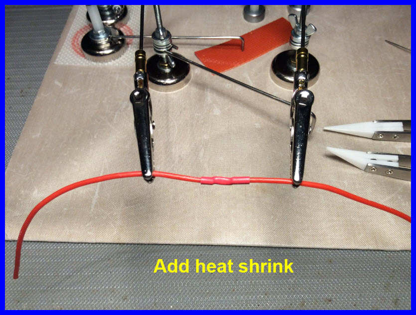

Add heat shrink

    Add heat shrink to cover the resistor and LED leads.
    Of course, there are wires soldered, not shown, solder the wires before you solder the resistor, make good soldering joints.

  • To help prevent wire breakage problems, use stranded 24AWG wire.
  • Use appropriate size heat shrink to prevent shorting.
  • Make proper soldering joints on a prototyping board.
But before soldering, remember to check you can slide on the heat shrink!
  • Actually if you forget, it will be the last time you will forget.
:wink:
