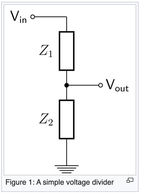

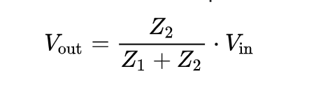

Assuming you will be using a 5v Arduino, then you will need to first lower the voltage from your input source. You can do this with a simple voltage divider circuit.
If you make the 2 resistors 10k, then Vout will be 50% of Vin.
