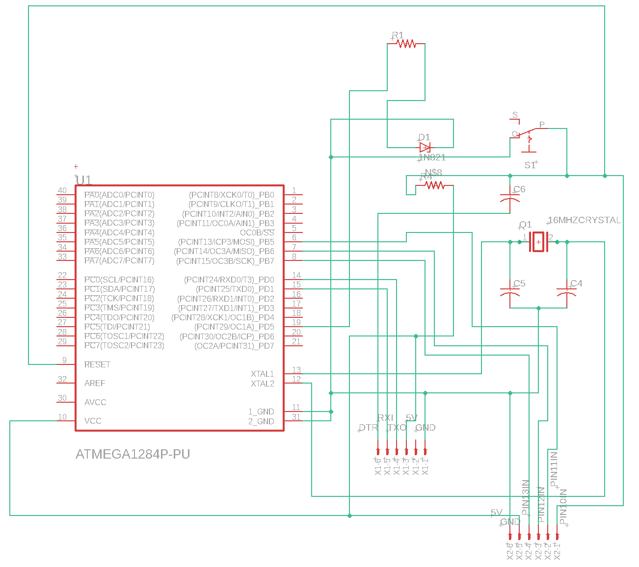

I built both the bootloader circuit and the serial circuit into one single circuit board. The idea is that I can flash the bootloader on, switch the connection, upload a sketch (like Blink) to test with the built in LED. The exact circuit I have created is shown below:
Anyone is welcome to use it if we can solve what is wrong in my problem..
This helps ensure that the connections are solid and much more repeatable for testing. Next I have tried to install a bootloader. Since I have an Arduino Uno R3, I plug it in as the article shows, with my circuit I created.

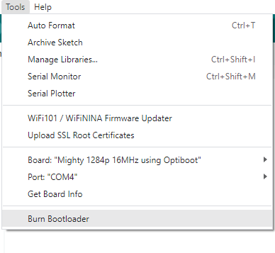

When using the "maniacbug Mighty 1284p 16MHz using Optiboot" bootloader, I place it into the hardware folder as recommended:
When selecting this as my bootloader, the "Programmer" option disappears:
For this reason I trialed "Goldilocks 20MHZ" which does have the "Programmer" show up:
Selecting Programmer = Arduino as ISP, the port, and Goldilocks 20MHZ, I click burn bootloader and it tells me success!
Interestingly enough, if my reset switch is turned to on, it won't burn the bootloader successfully. I only say this as this is my only proof that something is recognized but I will get to that..

No decoupling capacitors is one thing that stands out.
C4 too far away from the crystal.
You might want to add a buffer electrolytic capacitor on 5V.
Note that my knowledge of electronics is basically 35 years old.
So really adding a capacitor on this leg:
0.1 uf?
and shortening my run to the crystal (which I see clearly now). Would these really prevent the board from programming though? I am definitely not as experienced and trying to learn but isn't the decoupling capacitor to suppress noise, which I agree is good for robustness but would it prevent the board from being programmed at all?
Not like that, C5 from 5V to GND.
Look at the schematic of e.g. the Mega which pins need decoupling and the value for your C5.
Have a look at MightyCore's recommended minimal setup. MightyCore is also the more popular Arduino core for the ATmega1284P.
@hansibull That solved it! Using MightyCore with my new board successfully worked! Thanks so much!
