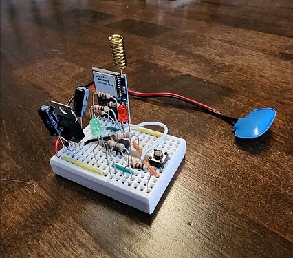

Hello,
I recently made a simple LoRa remote control. This remote control would use an Arduino Nano to send out a serial command via a Reyax RYLR896 LoRa module that would transmit to a receiver. Pressing a button on the remote control would turn on an LED on the receiver. Very simple, worked flawlessly.
I have since attempted to remove the Arduino Nano from the remote control side and move the entire project over to an Atmel Tiny85 (I THINK this is the same as the Attiny85). Aside from changing the GPIO pins, the code remains essentually unchanged. Unfortunately, it does not work.
Pressing the button on the remote works, as the "transmit led" on the remote flashes, letting me know that the button has indeed been pushed and detected, however the LoRa singal is not transmitting. I've never used the Software Serial library on one of these Attiny chips before, so it's possible that one of my settings is incorrect and would appreciate any advice.
NOTE: This code DOES compile and upload to the Attiny chip.

Could you post a drawing of your circuit?
My understanding is the ATTiny85 has no hardware serial peripheral, so software serial is the only option.
Can you say how you are programming the 85? Are you using a separate programmer or Arduino as ISP, or are you connecting directly via USB?
I don't think you can power the Lora module with a voltage divider. Did you do that when it was a Nano circuit? Anyway, if you can post your schematic, we can see how you have it set up.
Edit: Forgot to say, the correct processor speed to select is the one that makes the Blink example sketch blink at the right speed.

Thank you so much for commenting.
I was just about to draw up a circuit diagram for you, but I tried something first. That is, I added a second Voltage regulator to power the LoRa module. This worked. I can now transmit data from the remote control to the receiver and turn on my LED.
HOWEVER, for some reason, I'm unable to receive data back from the receiver. In my firmware, I created an asynchronous acknowledgement so that I could be notified (via an LED on the remote) if my signal was received. And while I've confirmed that my receiver is transmitting the acknowledgement back, the remote isn't receiving it.
NOTE: To test, I had the receiver running normally and transmitted serial commands manually with my FTDI programmer and the remote control's LoRa module. Via the Serial Console, I was able to send my commands, turn on the LED on the receiver, and then receive back the acknowledgement, which printed in the serial console. So the logic works fine and the modules are seemingly working correctly.
I tested the continuity between the TX pin on the module and the RX pin on the Attiny85 and it seems to be fine. Could this be an issue with the baudrate? Everything is currently set to 9600.

I know you think you've described your system accurately, but I am unable to picture it without a drawing. Maybe someone else can help figure out the ack signal. But I should say that I've just told you everything I know about Lora. So the drawing might or might not help.
Sherman,
I understand.
My only thing is that the line from TX pin on the module to the assigned Software Serial RX pin on the Attiny is just a single jumper. There are no other passive components in series or parallel with the connection. Everything else is working fine, including two indicator LEDs and the input button; so I don't believe it's a wiring issue. Additionally, the module is transmitting properly, so it's not as though I have the RX and TX lines swapped.
I think now that the issue is limited to the following:
  1. The Attiny85 cannot read serial communication from pin 2. I've not seen anything online to indicate this.
  2. The baude rate is set incorrectly and therefore interferring with how the Attiny85 reads serial communication.
  3. The 3.3v serial signal coming from the LoRa module is not compatible with the Attiny85. Perhaps a resistor or voltage divider needs to be added. This just popped into my head as I was typing so I will continue my investigation here :bulb:
  4. Some other programming/processing factor that I'm not aware of.
If you want, I can post a picture of the remote in the meantime :grimacing: Sorry I'm being lazy with the schematic, I just don't think it's a worthwhile endeavor at this point.

I don't think the 3.3V vs 5V thing is the problem. If the Lora module is actually sending 3.3V, the Nano will recognize that as High. So there shouldn't be any need for voltage translation.
I think the first thing is to determine if something is being sent at all. I assume you don't have a scope, but do you have an LED you could rig up on that line? You could connect the high side of the LED to 3.3V through a resistor, and the low side to the line. Then if the line goes low for traffic, the LED will flash. I'm assuming that line idles in the high state, which you can confirm with your multimeter.
Otherwise, I just don't know anything about Lora or really the 85, so I don't know how the baud rate is set. Well, software serial presumably lets you set the baud rate on the receive side, but I don't know how Lora handles that on transmit.
Sherman,
After doing some digging, the Attiny should be able to receive serial communication between 1.8V and 5.5V, so that shouldn't be a problem.
I DO have a scope and could see the RX line drop appropriately. And only when the receiver was powered on (just to rule out any false positives), indicating that the acknowledgement was received by the remote control's LoRa module. And that's correct, the line idles HIGH.
Both of the LoRa modules have their baud rates set with AT commands and are both set to 9600, matching the SoftwareSerial objects on each controller.
It's as though the serial data is just hitting a brick wall at the IC pin. It's quite frustrating.
All that's really left to test is various baud rates and possibly a different set of Rx/Tx pins on the Attiny.
Otherwise, I'm out of ideas :confused:

Sherman! That was a brilliant idea!
I wrote some code for my Nano to print out whatever data it receives and connected its Rx and Tx pins to the Rx and Tx pins on the Attiny85.
It received +RCV=715,1,A,-54,33. So at least we've confirmed that the module is receiving properly.
After looking at the Reyax documentation, the numbers after the 'A' seem to be
RSSI: Received Signal Strength Indicator
SNR: Signal-to-noise ratio
I'm not sure why this would affect the indexOf() method, but I'm going to trying simply checking for any available serial data (not specifically the 'A') and see how the Attiny responds.
UPDATE
So, this "works", however, because I'm only looking for available data, it receives a false-acknowledgement (I THINK) in the form of the "+OK" that gets sent after a successful AT command.
So, now I'm just trying to figure out why the Attiny doesn't like indexOf() and trying to find some other method for reading the 'A'.
I think that's it
