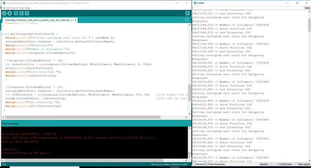

The last issue I have is the turning-off LED when the code is checking for the number of followers. Its just turning off for 500ms when its waiting for response and turning back on with the new intensity- matching the new number of followers. Is there any way to fix it? Picture of the serial monitor with data below. Also it does switch off completely when it exceeds the range <0,255>. I tried 'if' command in different organisations but with no results.
if(response.followedByCount != 0){
  InstagramUserStats response = instaStats.getUserStats(userName);
  int ledintensity = map(response.followedByCount, MinFollowers, MaxFollowers, 255, 0);
  if(ledintensity < 255){
   ledcWrite(ledChannel, ledintensity);
   Serial.print("Led Intensity: ");
   Serial.println(255-ledintensity);
I am so sorry for asking so many questions. I highly appreciate any help!
