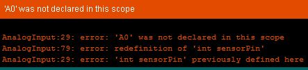

My program will not compile using the new version 1.0. It throws up an error on the analog pin declaration. To check I tried to compile the example AnalogInput program provided with the download. This throws up the same error also:
" 'A0' was not declared in this scope". Any suggestions?

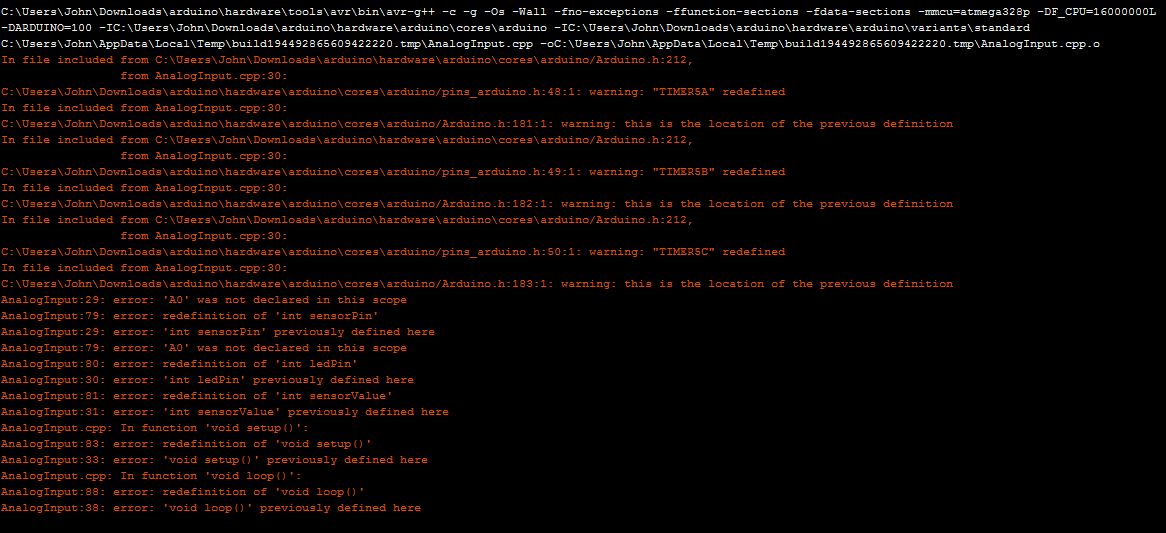

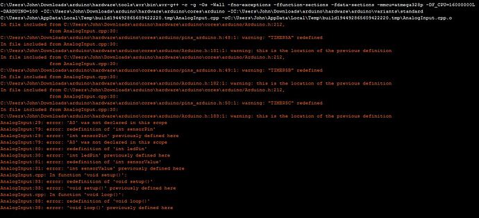

Can you enable verbose output during compilation (in the preferences dialog) and post the full text of the messages you get when trying to compile? That might help us figure out what's going on.
Thanks, Mellis. I've just opened the AnalogInput example included, and run the Verify over it. Here is the verbose output. I couldn't find a way to copy the verbose output directly to the clipboard - only the code itself would copy (and that is included with the program). So I've attached a .jpg copy...I hope it's readable.

I managed to solve this problem by removing all traces of the Arduino download from my computer, and then re-downloading. I guess there must have been some corruption in one of the files...
