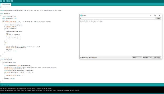

I tried both “Newlines” and “NL&CR”. Baud rates all match (9600). I am using UNO R3. I attached an image of what I see in the monitor.
OP image. How to post images.

What are you entering in the send line? I get a response even if I enter text.
some text I received: 0.000 Error! 909090 I received: 909090.000

I know it looks silly but I am relatively new to programming in general so I wasn’t sure what was the correct format or what dictates that and tried all the ones I know of. The only thing that is outputted is:
Even when I try to type in numbers/letters in any of those formats.
OK. I am officially baffled.
123 I received: 123.000 <123> I received: 0.000 Error! 123\n I received: 123.000 <123>\n I received: 0.000 Error!
Do me the favor of starting from scratch. Close the IDE. Open a new instance of the IDE, select and copy the code from reply #4 and paste it into a blank IDE window. Upload the code and try it again in a new serial monitor window.
If you unplug the Arduino while the serial monitor is open, the serial monitor loses the connection and serial monitor must be restarted (closed and opened again) to restore communication.
@groundfungus That worked! I guess restarting it is what did it. I just have another question that stems from this. In response #6 you quoted the output and in it there are additional numbers that are outputted in a new line under each “I read: ###”. What do those numbers represent?
