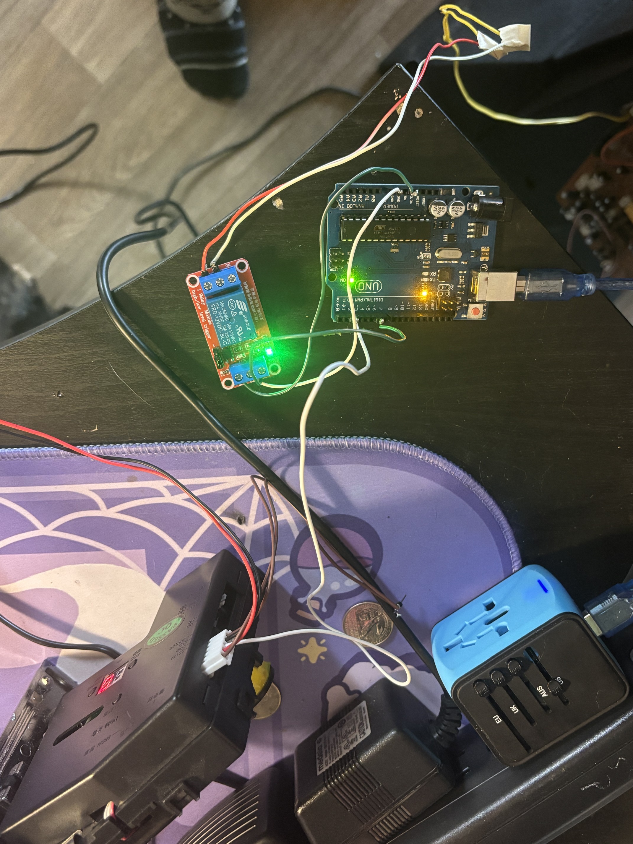

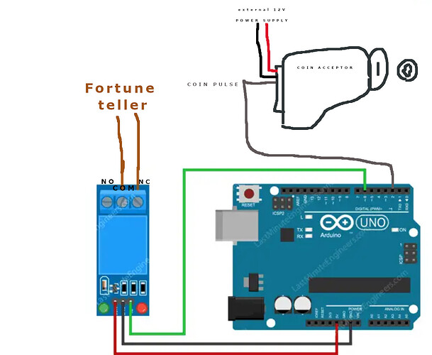

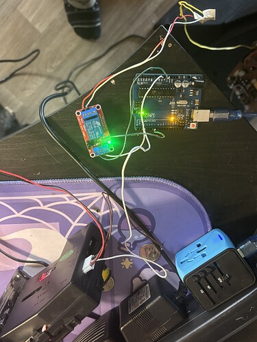

Hopefully this isnât too confusing a mess to understand. External power to the coin acceptor. USB to power arduino. Arduino powers the relay. Relay connected to pin 6.
Coin acceptor connected to pin 2 using the âcoinâ wire that comes off the mechanism. The user guide said thatâs what sends the pulse.
Coin mechanism programmed to send 1 pulse per quarter.
From what I can tell, the relay side is fine, except your odd choice of the normally closed contacts.
Normally, the two wires aren't touching, so it seems more like you should mimic that, and have the two fortune teller wires normally not connected by the relay. NO. Normally open.

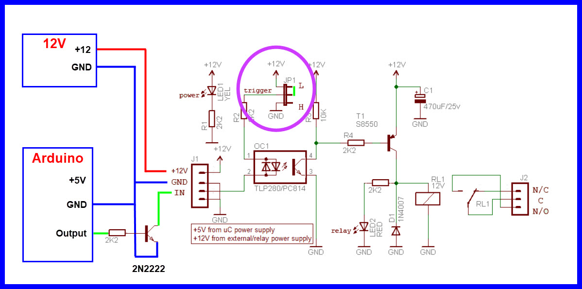

And as @LarryD days, you need twelve volts 12 to run the relay; even if you find a five volt 5 equivalent, you should not take power for it from the Arduino board.
The logic signal that runs the relay is fine coming from an output pin, and writing it HIGH and delaying a bit then writing LOW should work.
Or maybe LOW, then HIGH, depends on the relay module, some can be configured to work one way or the other. But that's just an experiment or two once the relay is properly powered.
