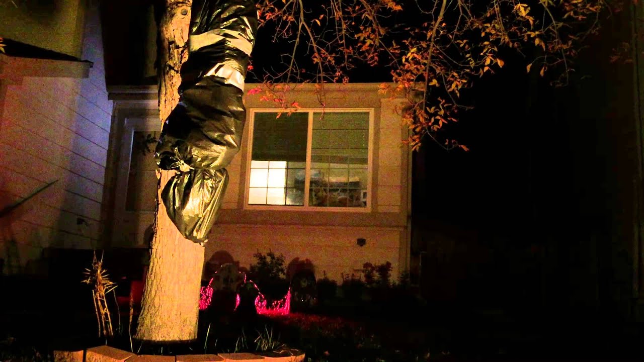

Hiya! I'm building a Halloween prop based on an animatronic body bag project I found on Thingiverse. The project is many years old at this point and the build required a lot of little tweaks here and there to assemble properly. The original parts list included some servos that are no longer made by Futaba so I had to buy the updated versions. The code, however, doesn't quite work as expected. The servo pulses tend to turn the pulleys in one direction and then keep pulling in that direction after a series of rather long delays. The expected outcome should be like this video:
Here's the code. Your guidance is greatly appreciated:
