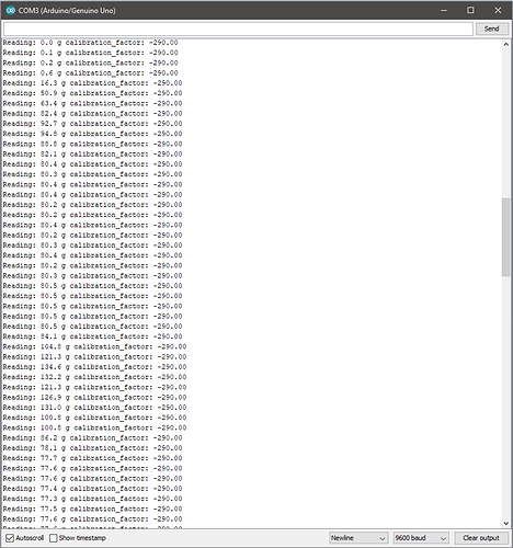

It is measuring the right weight, as I know the weight of the object just not sure how I get that value back to my program and use it.
(Picture of serial monitor)
Thanks for the help I am super stuck!
Mradobe:
There is no need to get the value back to your program because it never left the program in the first place.
Try this little change
  scale.set_scale(calibration_factor); //Adjust to this calibration factor
  float scaleValue = scale.get_units();
  Serial.print("Reading: ");
  Serial.print(scaleValue, 1);
and if that works then the value from the scale will be in the variable scaleValue and you can use it for other purposes
...R
