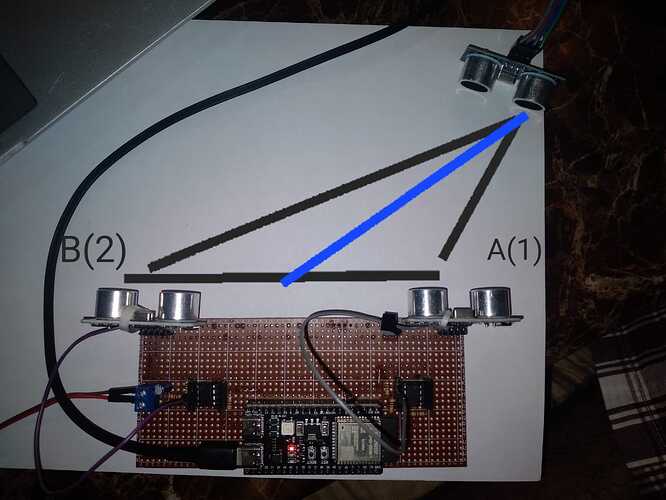

Hello everyone, I am still new to coding ESP32 so please be kind on my mistakes. I am trying to calculate the angle of arrival of a sonar signal using the time difference of when two receivers receive the signal. Below is a diagram and a picture of my set up. The distance between A and B is 13cm. A is connected to pin 4, B is connected to pin 5. I am using the raw signal from the OPAMP of the HCSR04 into a comparator (which also converts it into 3.3v) into the ESP32
and this is the circuit (each receiver)
Now here is the problem. At 13 centimeters, the maximum time difference i should get is 379us. But when the transmitter is parallel to the receivers, i get anywhere from 420-600us. And when i hold it and the middle of the receivers, the time difference is ±1us which is expected. This leads me to believe the circuitry is good but my code is faulty. Here is the code in question.

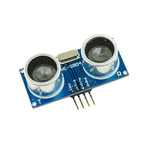

The HC-SR04 sensor works best between 2cm – 400 cm (1" - 13ft) within a 30 degree cone, and is accurate to the nearest 0.3cm.
From
I.e., 15 degrees each side of a straight line perp to the board
What is the purpose of this op-amp?
If you are attempting to convert the 5V pulse from the sensor to 3.3V, I do not think it will work. The op-amp is powered with 5V and will output 5V and could damage the ESP. The pull-up resistor won't fix that. Anyway, no op-amp is necessary to convert to a 3.3V signal. Just a voltage divider.
As pointed out above, the sensors have narrow 30° beams, so anything more than 15° away from the centre line is unlikely to be reliably detected. Is it possible what is being picked up is an echo from some other object which is further away? That could explain why the difference is more than expected.

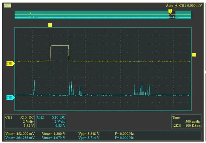

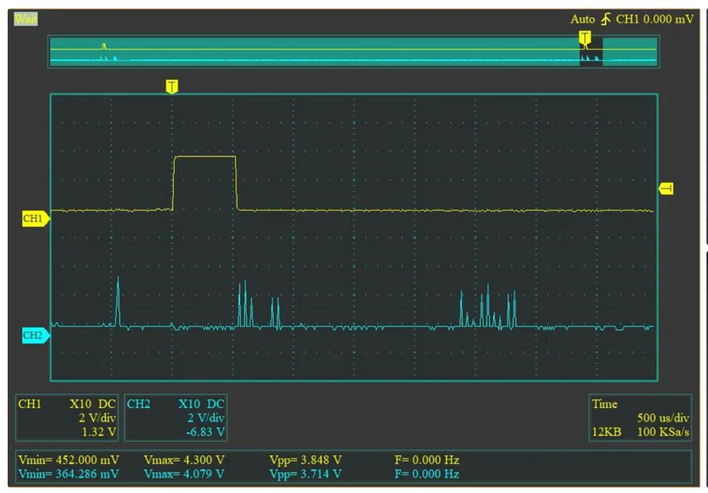

The pulse you are talking about here is the yellow trace. The reason i cant use the echo signal from the sensor is because it only sends out one after the sensor has fired. That means a signal is out in the air, that will interfere. Thus i solder a wire directly to the sensors opamp. And that means i deal with the bottom trace now
The opamp signal goes into a comparator to digitize and also set the voltage level to 3.3v (see the pullup resistor.

The echo pin cannot be used for passive listening like i am here. It is meant to give out a signal proportional to how long the transmitted signal took to came back.
For my 'passive listening' i am instead using the 'raw signal' directly from the last stage of the TL074 chip on the sensor
Have you checked with your scope to see if the time difference between those two signals at the two digital inputs to the ESP32 corresponds to the values your code is producing? I'm just thinking that would indentify whether there's something wrong with your code, or something wrong (or at least unexpected) with your hardware.
Ok, I understand a little better now. The third sensor (not labelled, let's call it "C") is sending out the pulse, and sensors A and B detect it. Sensor C isn't used to receive anything. Sensors A and B don't get triggered by the Arduino, so don't send any pulses, but they receive the pulses from C.
This part I still don't get. I don't think it will do that. Does the op-amp used have an "open-collector" output?
Another thing that struck me. How are you allocating the 2x ISRs to the ESP32's 2 CPU cores? If they both run in the same core, they can't execute simultaneously as they would need to when the signal is directly ahead.

  2. That hadnt struck me actually. This explains why i could never get the difference to come out at 0, always plus-minus 1. This seems to be the reason why. Id like to use the other core for wifi and whatnot still so i think i can live with that 1 microsecond.
