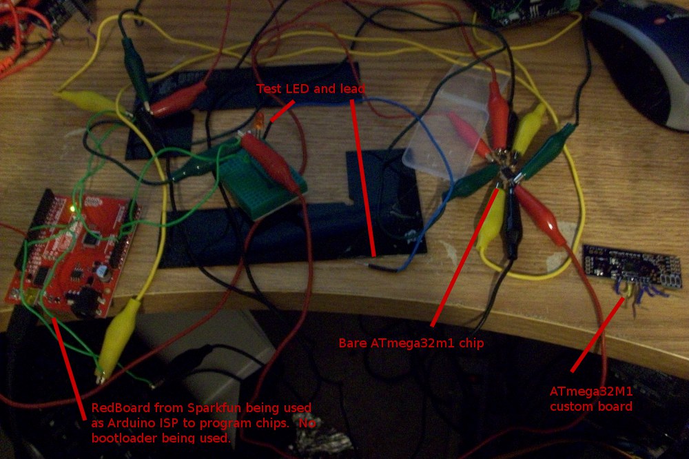

So my test process is:
I will copy someone else's code (like Coding Badly's) and use it as is and test the physical PB1 pin (because that is the one in his code) with an LED & test lead (as shown in the picture). I then test all the other physical pins with the LED & test lead while still running the same code. Then I change the code so that it points to pin PD1, and check to see if the built in LED "blinks." If still unsuccessful, then I test all the other pins with the LED & test lead while still running the same code. I repeat the same process with the bare chip as shown in the attached pictures.
Yes, I do have the ATmega32M1 (three of them!). Yes it's naming convention is confusing!! It is not pin compatible with a chip like the ATmega32U4 either! It has been a bit frustrating searching the internet for info and other people's work concerning the ATmega32M1 because all the other "ATmega32..." chips come up as hits too (like that ATmega328, ATmega328p, etc.).
Attached is a picture of my test setup with the RedBoard as the ISP, LED & test lead, and the ATmega32M1 bare chip.
Attached is a close up picture of the ATmega32M1 bare chip attached to the RedBoard ISP.
Attached is a close up of the custom board I made for testing the ATmega32M1.

Do you have a pull-up resistor attached to the RESET pin?
Coding Badly, I do have a 10K pull-up resistor on the Reset pin of the custom board and I've added one to the bare chip setup.
Use avrdude to read the current fuse bit settings. Post the settings. If you need help, say so.
Coding Badly, I forgot about being able to read the fuses via avrdude. Thanks. Here is what I got off the chip:
lfuse: 0x62
hfuse: 0xdf
efuse: 0xff
lock: 0x3f
Now I'm going to look up what that means!

The processor is configured to run at 1 MHz. Ensure f_cpu is...
atmega32m1.build.f_cpu=1000000L
...and retry one of the simple programs from above.

Coding Badly, I too like engbedded's calculator. Even though it seems like the suggested default fuse settings for the ATmega32M1 is wrong on that site, I like how easy it is to visualize and manipulate the fuse settings there.
I have set the board.txt's setting for the microprocessor's speed to 1MHz (1000000L). In my original post I do show a setting of 8MHz, but that was because I had changed it just in case something in the fuses had been changed and the microprocessor was looking for a different speed. With you reminding me concerning reading the fuses via avrdude, I was able to confirm that the chip is still expecting 1MHz. Thank you.
Since I'm not using a bootloader would this matter?
No.
What do you think? Would it hurt to go back to default settings (according to the datasheet, not engbedded's suggested setting)?
It would not hurt but it would not help.
Do you see anything in the fuse settings that would keep the uploaded application from loading?
No.
