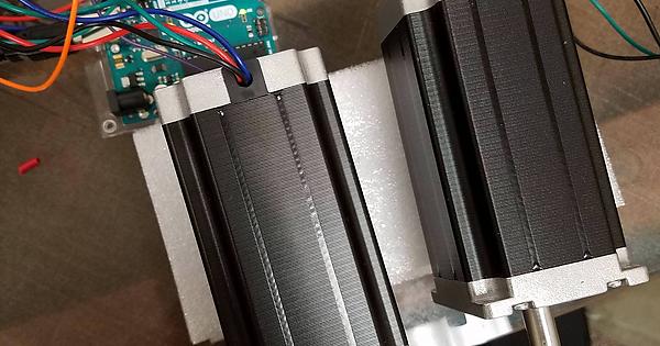

Trying to run Stepper Motor to certain position then change speed

What does it do? We can not see what you have between the Arduino and the stepper motor(s). We can not see how you are powering the stepper motor(s).
Way more details are needed.

There's power draw, a whining noise, but the motor does not turn or do anything. In the pictures, the stepper motor is only the one with the white disk on the shaft. I have a second stepper motor and driver but that's not running right now. I'm trying to get the first one working first

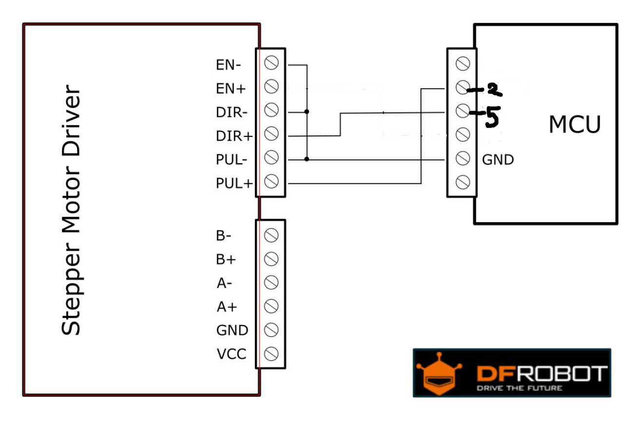

That driver should work with the AccelStepper DRIVER option. Actually, to be more direct, the DRIVER option is the proper choice for that driver.
Make a simple pencil drawing showing how you have everything connected and post a photo of the drawing. See this Simple Image Guide
...R
Never mind, dumb Q. :confused:
Here you go Robin, I don't have the Enable pin connected to anything as it seems to serve no purpose for me. but the numbers in that image are the pins everything is connected to. I looked up the difference between a common cathode and anode connection but it seems arduino has no preference so I just grounded all of the - pins together. Hope this helps you help me
Sorry but, you say 3200. Is that 3200pps or 3200rpm? If rpm, it's never going to happen. The fastest I've ever run a 23 is just over 2,000rpm and that speed was approached very slowly. Plus, you've got almost zero torque over about 600rpm. If you want high speed with a stepper, look to attaching a gear. Also, once you get above about 100rpm, micro-stepping is a waste of time.
That setup should work fine with the DRIVER option. Pin 2 is the step pin and Pin 5 is the direction pin.
