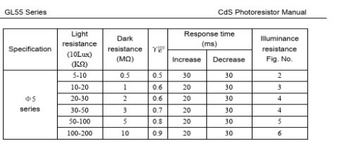

Do you have a link to the photoresistor with such parameters?
I'm using the one that is sold everywhere, GL5539 i think??
this one in the link says 5 million ohms in dark, and 30 - 90k ohms in light
30k ohms - It doesn't look like a closed button, does it?

30 ohms not 30k ohms
What do you mean unrealistic? it works. It works on my pc power button, it works on my xbox controller buttons.
it obviously means "30k..90k Ohms"

I must have ones slightly different, i measured them in full light at 70 ohms, and 8 million ohms when covered in blue tac.
