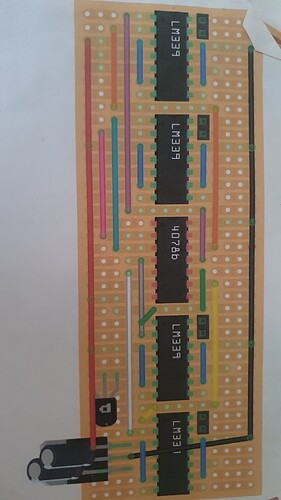

All of those except the reciever response, I can substitute an original tsop into the same circuit and it works, but the tssp doesn't
Do you have access to an oscilloscope ?
Sadly not, but I do have a decent multimeter that will do hz etc
Show us good images of the circuit.
Probably easier to get an idea from this, the lm339 chips harvest the sensor trigger and feed them to the nor gate in the middle, which triggers the arduino pin. There's a seperate 5v supply on there and a transistor for the ir drive, the 38k from the arduino pin switches the transistor. Works lovely with the original sensors but my supply of replacements is exhausted.
Schematic please :nerd_face:
Don't have one Larry, I probably did have when I built it but my notes folder is pretty poor...... Lesson learned.

It is still not clear exactly what you have connected the output of the TSOP4038 to. Maybe try an external pullup resistor on it (say 10k).
The outputs are connected to lm339 comparators. I used this method so that I could group a bank of them to achieve a single output.
The TSOP4038 / TSSP4038 have open collector outputs so multiple devices could be connected together in parallel without problems.
There is probably a lot I did that could have been simpler. I researched and built with zero previous electronics experience other than 12v vehicle electrical systems. It's 8 years since I did so and I don't remember all the details but I think I may have used this method as it gave me an option to add an individual led per sensor for alignment purposes.
