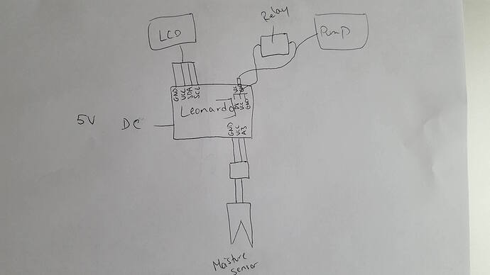

Hi, I am creating a automated plant watering system. The only problem I am having is that my water pump does not want to turn off when the moisture sensor reads that the soil is moist. Below is my code. If anyone can help me out it would be greatly appreciated.

You might want to run the pump for a certain amount of seconds, and then have a timeout of say 15 minutes before you check moisture again. Moisture sensors and soil take time to settle.
Not sure what sensor you got. Most bare/resistive ones are very unreliable and temp dependent.
Are you sure 1023 (maximum A/D) is what the sensor outputs if plants need watering.
You might want to test with the raw A/D data first, before you map it to 0-100%? for the LCD.
Leo..
I've attempted to add a timer onto my arduino but the pump still wants to run. Sorry I am new to this.

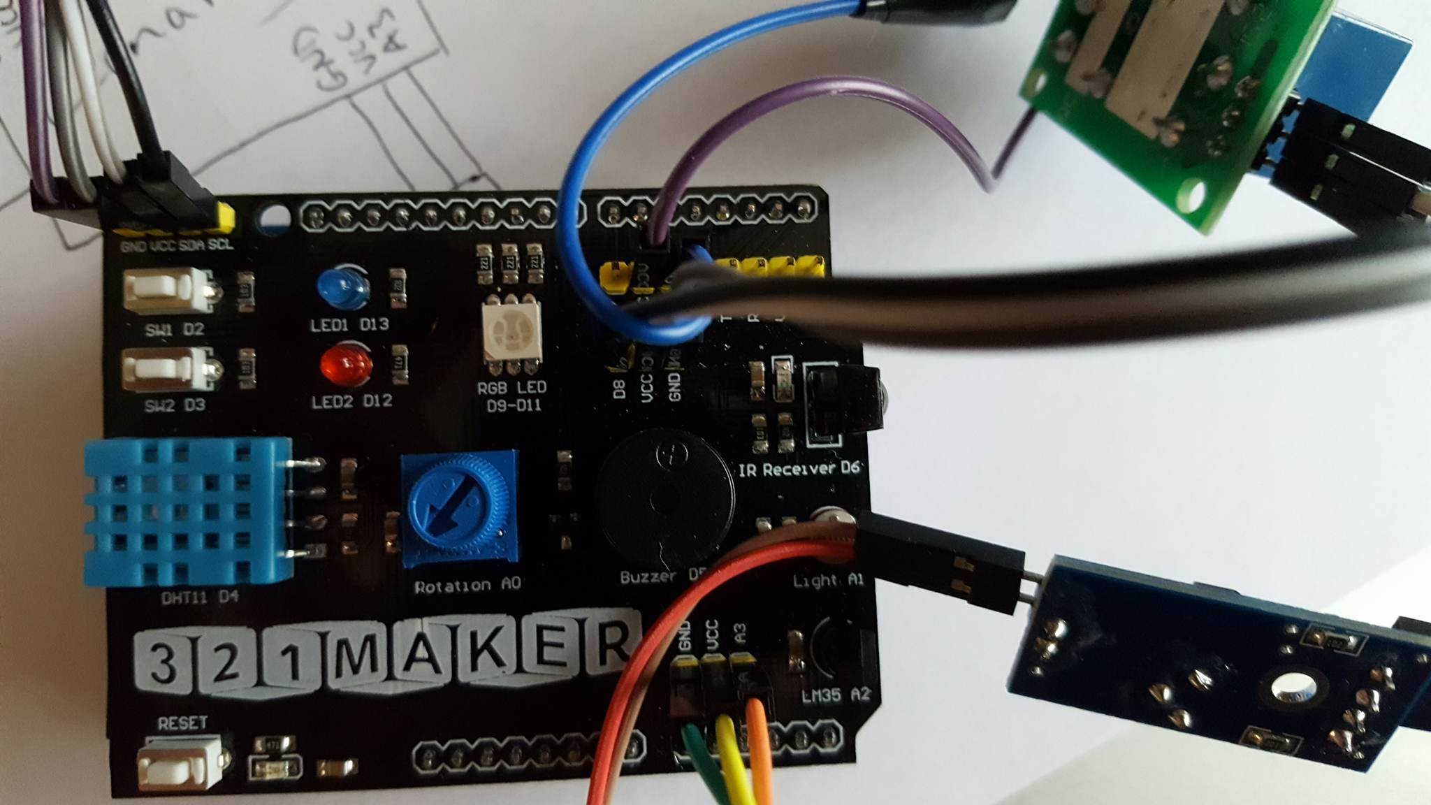

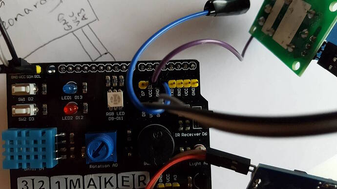

Please post a hand drawn (not Fritzing) diagram showing how everything is wired.

Ok so if I just wanted it to read the data and if it was below say 40 to water the plant for 10 seconds and then shut off without the delay how would I go about adjusting my code?
I have the pump now turning off and on every 10 seconds. So now I just need to adjust it to water once the moisture reads low.

Powering the pump and relay from the Arduino is likely to cause problems and may even destroy it.
jremington:
This is the way my teacher showed me how to connect the water pump.
Your teacher is giving you extremely bad advice.
NEVER power a motor or servo from the Arduino. It is only a matter of time until your setup fails.
jremington:
OK I'll hook up the pump to its own DC power adapter. Thank you. Now I just need to fix my code to get the pump to work properly
