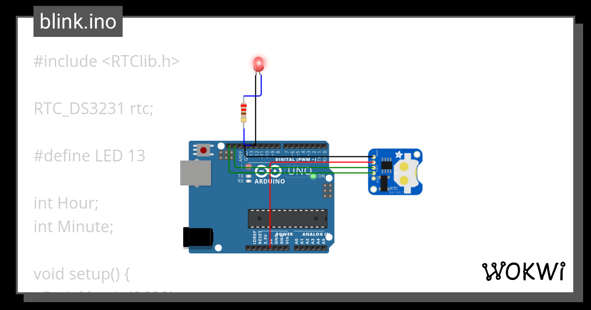

badly need help on this one
You need an extra variable that keeps track if the light is on or off.
bool lights;      // true when lights are on, false if lights are off.
  if(!lights and Hour == 18)      // 6 p.m. and lights are not on ?
    digitalWrite(LED, HIGH);      // turn light on
    lights = true;                // remember that the lights are on
  else if(lights and Hour == 6)   // lights are on and it is 6 a.m. ?
    digitalWrite(LED, LOW);
    lights = false;
          In your case, you don't need to know the minutes value.
You can avoid handling the crossover at midnight by looking when the light should be off - i.e if hours > 5 and hours < 18.
And rather than constant digitalWrites, use the idea suggested above.
          An extra boolean isn't need. The output pin state is the same as the boolean.
The state of the pin change once between 6 and 18 and once outside that time
  if(Hour >= 6 && Hour <= 18){
    if(digitalRead(LED)){
  else if(!digitalRead(LED)){
Hour == 6 and Hour == 18
Is tricky code. If the application starts at 19h it does nothing for the whole night.
          i tried this one and it worked, thank you so muuuuuch
