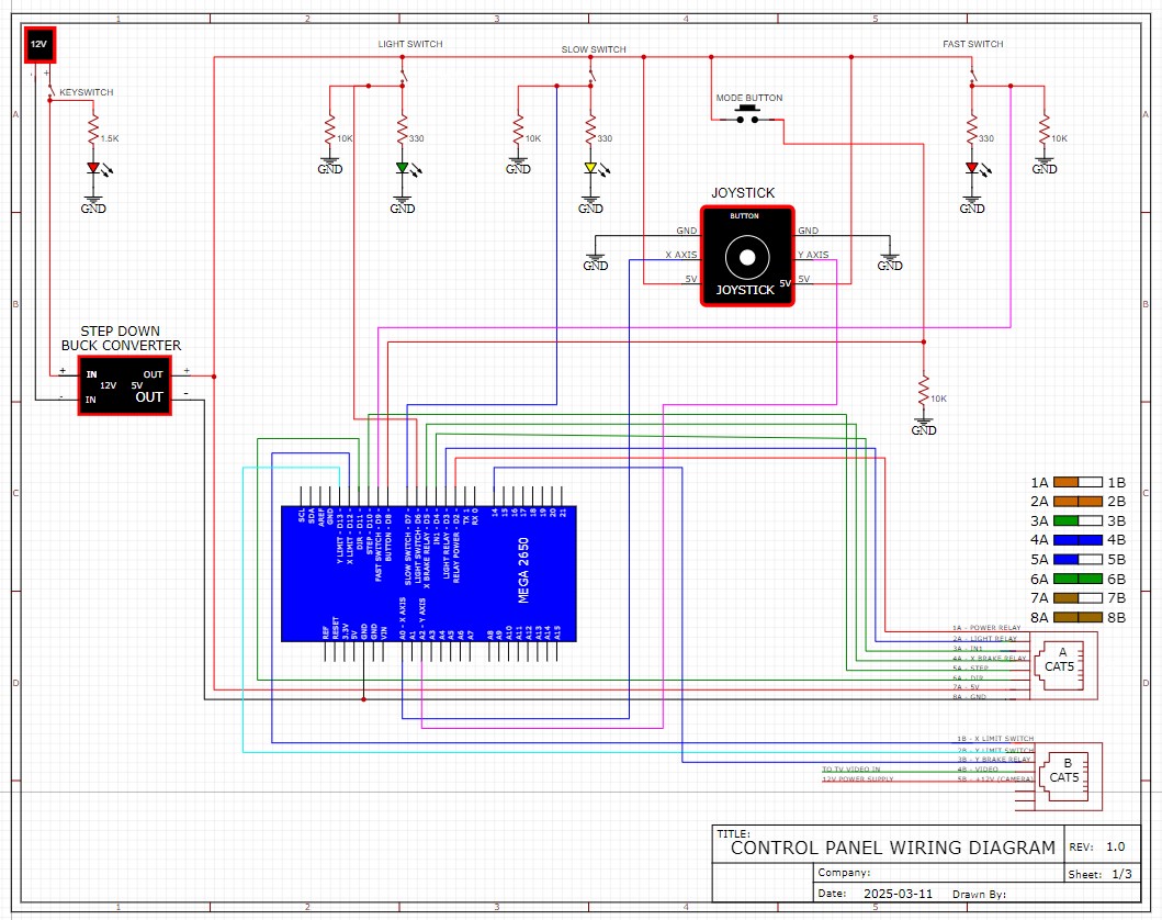

If I have two Nano's. (Nano1 and Nano2) Every digital and analog pin is being used except D13 and A0 on Nano1 and everything except D2 on Nano2. Is there a way to send data to Nano2 using only one of the remaining pins on Nan01?Then recieve that data on Nano2 to work relays, stepper motors, dc motors etc. Would something like this example work? The question marks aren't part of the code, I just don't know what to do there or if it's even possible.

They would be separate (200 feet apart) and running 2 seperate codes. Why would it be a bad idea? Is it possible though? Has it ever been done before? I could use a Mega but I would have to run another 200 feet of cat5. So my question was can a single digital pin on Nano1 write different values (other than HIGH and LOW) to a single digital pin that can read those values on Nano2? Is there a more simple solution? Do beginners usually send wiring diagrams like this?

Everything seems to be working fine with the cat5 at that distance. Hardly any voltage drop.

Decided to use a Mega 2650 and run another piece of cat5 200' long.
