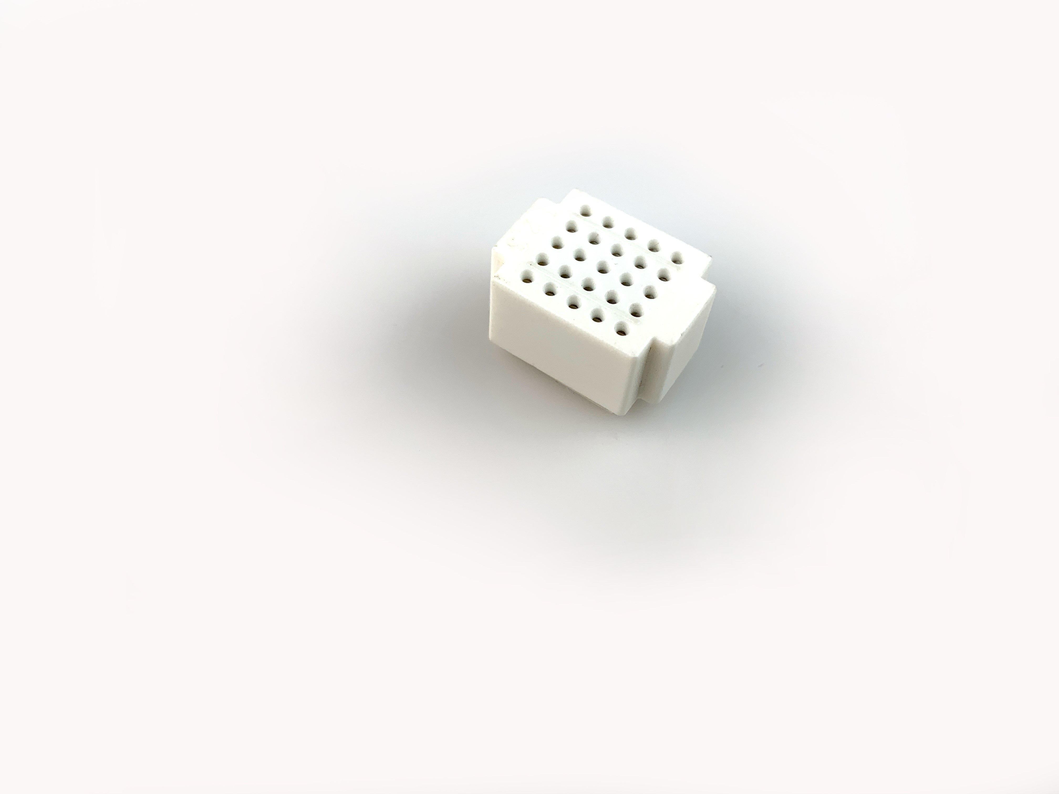

Also that's not a mid-sized breadboard, it is very small. And the correct term is "stupid sparkfun plastic plate". Why do a reputable company like Sparkfun sell such nonsense? For the same price you can buy a descent size breadboard and a breadboard compatible Arduino like Nano.
(Apologies for the off-topic comments)
But good suggestion about using a bus-bar for the i2c bus. My favourite breadboards, the K&H AD100 series (the ones with 6 hole rows) have detachable bus-bars that can be purchased separately, so you could attach an extra bus-bar for i2c while still having power bus-bars at both sides.
I would have gone the nano / decent sized breadboard years ago had I known better.
This is a very small bb :wink:
blomcrestlight:
Sparkfun, by selling that plate, are suggesting to beginners that it's a sensible thing to do.
Where? I can't... Let me get a magnifying glass...
