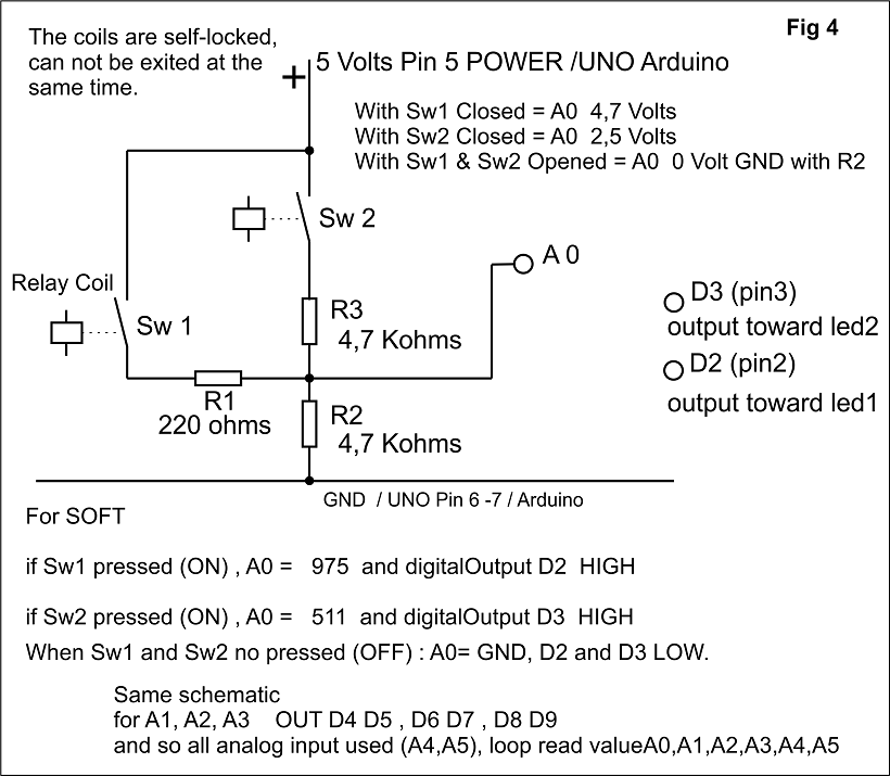

Hello,
Ok, but for the output (s) D2 and D3 the Leds, when SW1 and SW2 are open , the Voltage on A0 will be zero Volt
and the two LEDS will be state LOW.
if close SW1 : A0 will be 2,5Volts
and the LED on D2 light (HIGH)
if close SW2 : A0 will be 1,66Volt
and this is the LED on D3 will be lighted (HIGT)
On my old schema with pull up, thre is the 5Volts on A0 ( but with pull down A0 will be Zero Volt.)
When is starting, SW1 and SW2 opened; the 5V is reading and the LEDS will be LOW or HIGH ???
Difficulties for me to start, this soft.
Please give me the way , Thanks
John.

Hello,
There is a Resistor to remove
Why install R1 ???
R2 and R3 are sufficients
Give me your idea , TKS.
John
Schematic as in #18?
Try it out... you'll see you get a reading of 1023 no matter which switch is pressed.
I have a new schema with resistors pulldown and i think what is a better solution.
You can see the new schema (Fig 4) in the attachment.
TKS
John
R1 can be omitted indeed.

"if value on A0 is contained between 5 Volts and 4Volts
then D2 High " // The LED1 High it's SW1 closed
"if value on A0 is contained between 3 Volts and 2 Volts
then D3 High " // The LED2 High it's SW2 closed
else (see others inputs, loop on A1 with same conditions, then on A2 A3 A4 A5 )
I call for help.
Thank you
John
Just use a set of if/else statements.
Yes, with if else for the 5 analog input(s)
