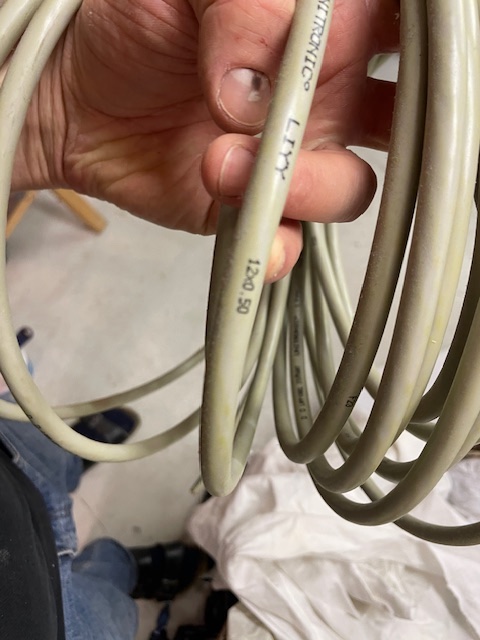

I found this in my workshop, would you think this is sufficient?
I did not see a better information on the cable. What you think?
The "12x0.50" looks like 12 separate conductors of 0.50mm^2. Maybe using 3 conductors in parallel would be the 1.5mm^2 equivalent of:
