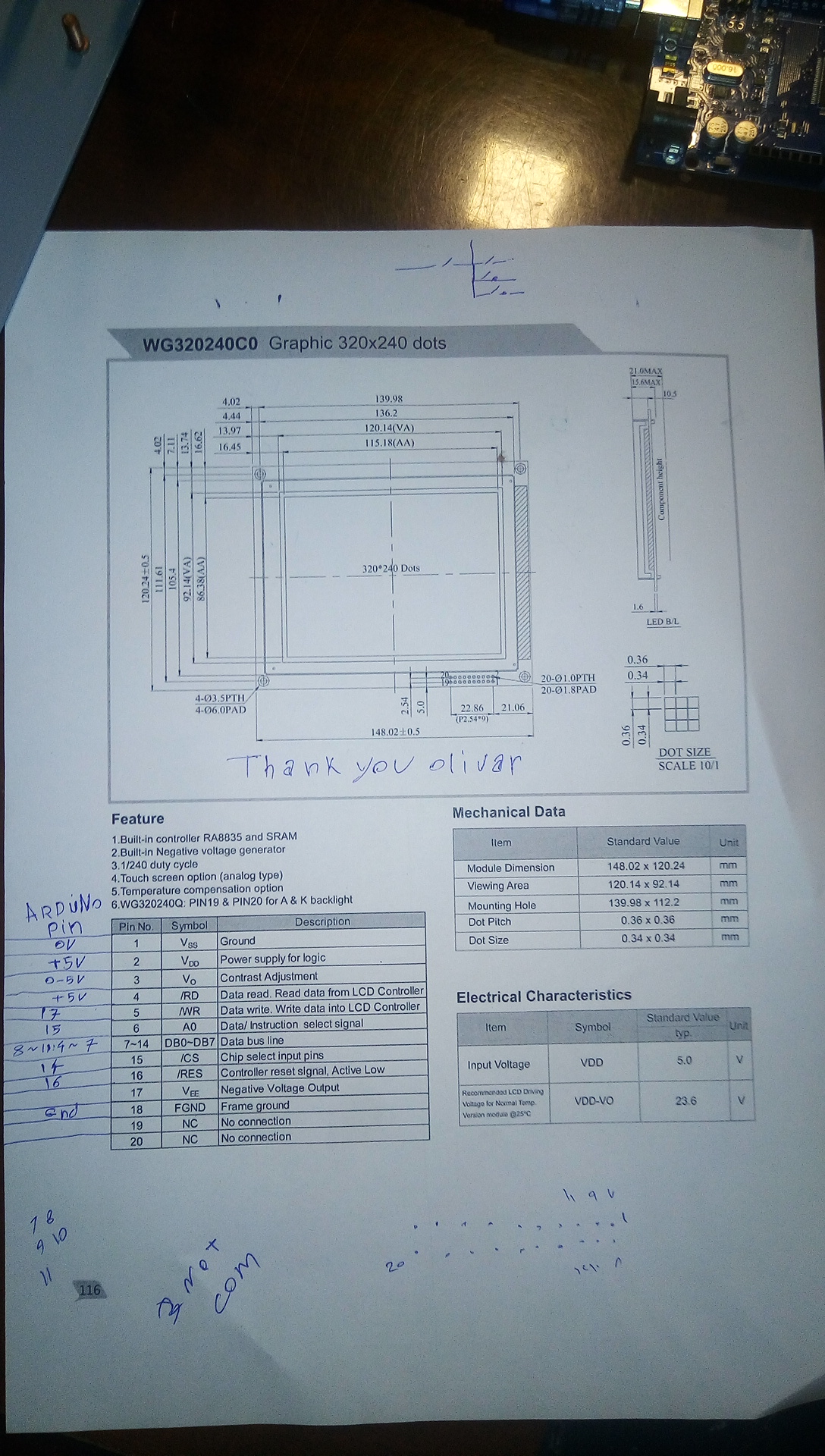

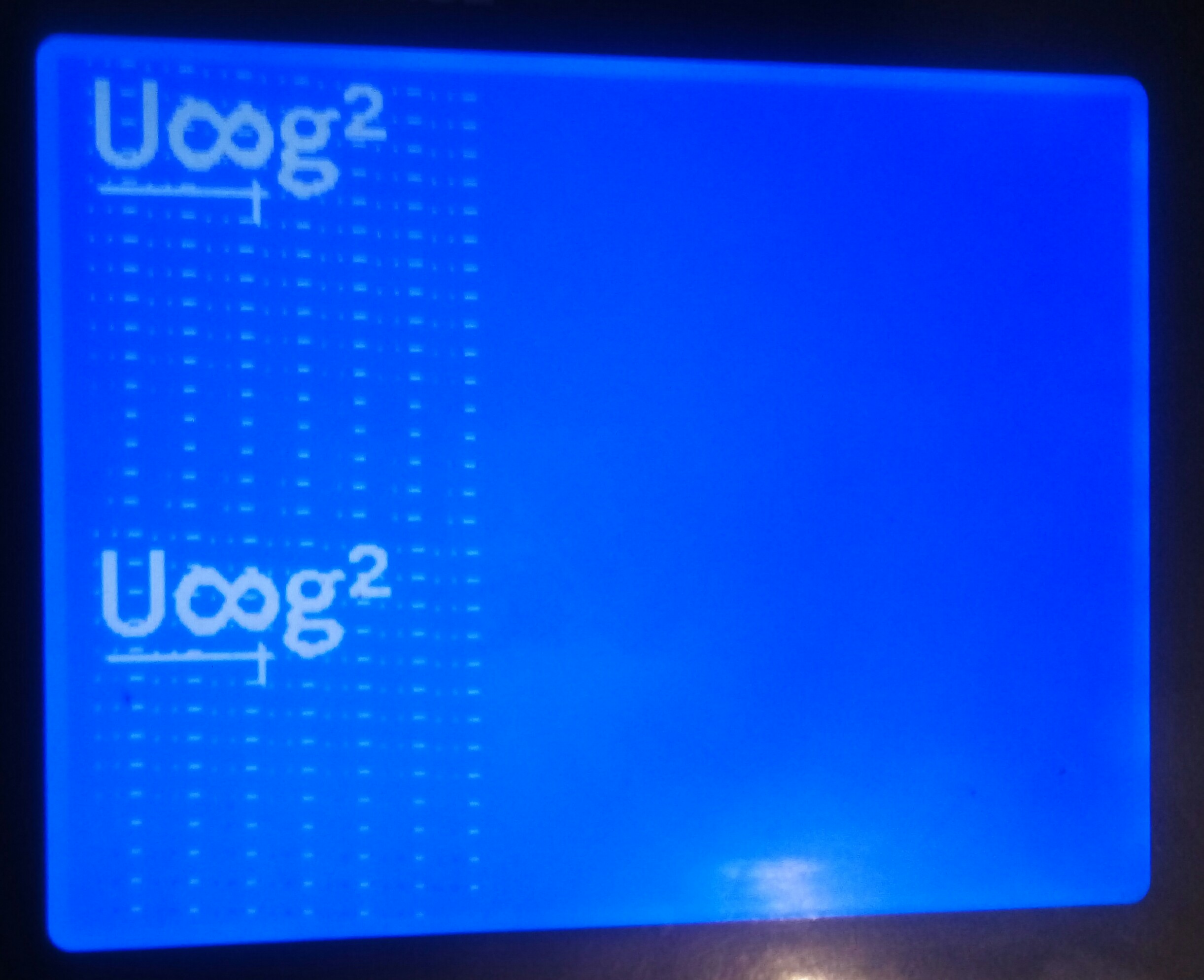

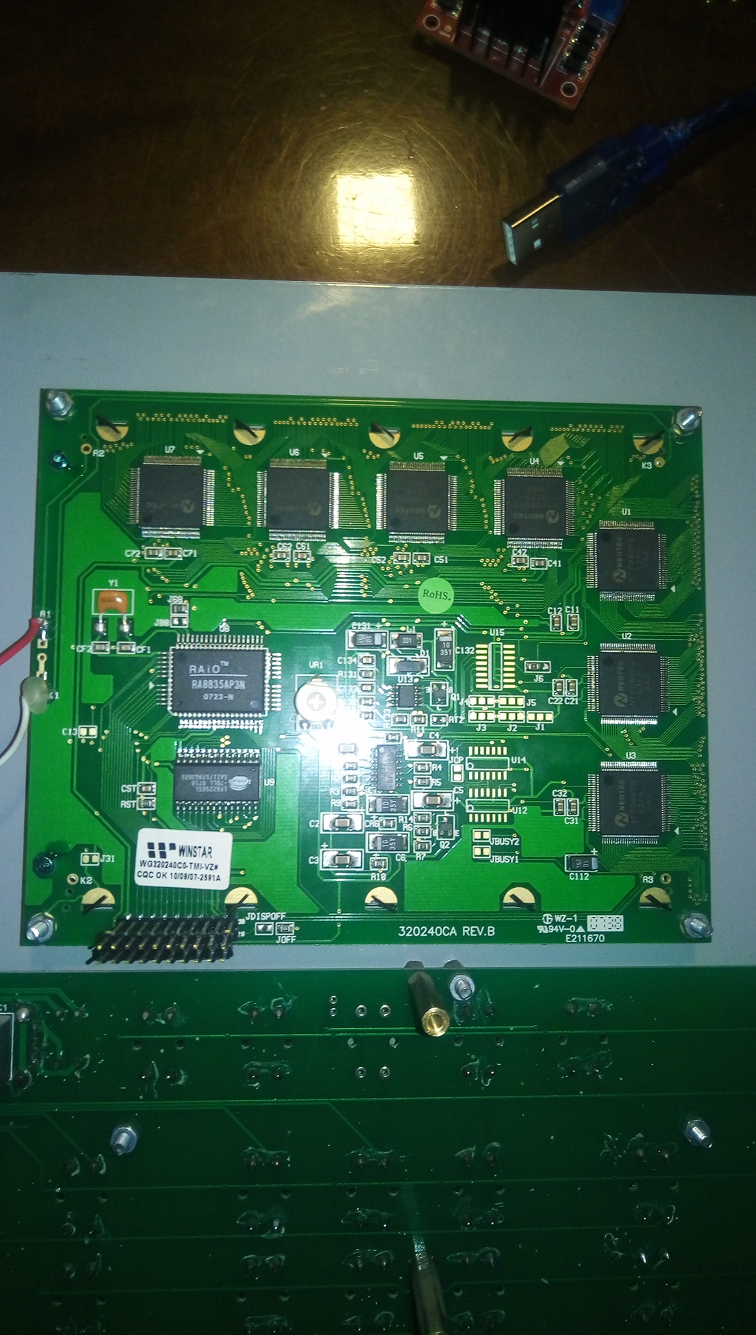

hi I'm nor form Syria I need some information for my display it winstar
wg320240c0 with raio ra8835ap3n
haw contact to arduino mega
I don't find these display in ur library
please help me
I'm don't find any information online
Oliver
thanks olivar bat I have a problem any thing Is dabbling in thes haw I can changing form 240X128 to 320X240
:slight_smile:
ok, so you are saying it works a little bit, but instead of the support for 240x128, you need support for 320x240, correct?
I have created an issue for this:
Oliver
yes please I need
My graduation project stands on this

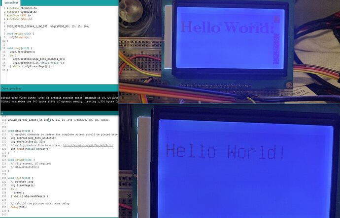

Hello.
I am hoping you can help me with a problem I am having.
I have a 128xc64 ST970 lcd.
If I use the U8G library it is fine, if I try the U8G2 library with exactly the same setup I get lots of ghosting and artifacting.
Would you have any idea on what could cause this ?
I have attached an image of the code and the respective output on the screen.
Large image link (Imgur)
