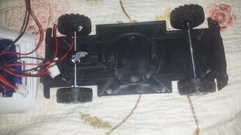

Here is what the base where all the parts are put looks like:

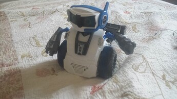

Here is what the robot looks like(representing a car):

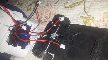

Here are the wires that connect the motor(only 2 wires connect the motor (2negative and 2 positive)):
Nope. No move at all The problem is not from the power.
The motors aren't even moving.
L298N motor driver is controlling 2 small geared motors
I am using 4.8V for the motor driver. The problem is not from the power. It works perfect as if I run another code to control it's direction without the ultrasonic sensor.
