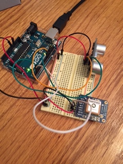

I included a picture of my wiring.

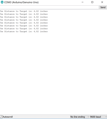

Yeah the USB is sufficient. when I open up the serial monitor, it is showing what I tell it to but, for example, if I have an object at a distance of 4 inches. the serial monitor will say its 4 inches, but then the next reading will be 1.00 inches, 0.5 inches, then back to 4 inches. So there is no real consistency to the readings. The GPS unit works fine though, it presents accurate information every reading in the serial monitor.
unsigned long currentMillis = millis(); //currentMillis is the time that the arduino has been running in milliseconds
  if(currentMillis - previousMillis>interval){  //should be a 3 second delay without the delay function
    ultrasensor(); //run the ping sensor
     // readGPS();
And now?
(Those are code tags, BTW. They're explained in the read me in bold at the top of this, and just about every other, section of the forum)
The ultrasonic sensor reports accurate values now. I see that you made the readGPS a comment so it has to be something with that function that is screwing up the consistency of the distance sensor?
