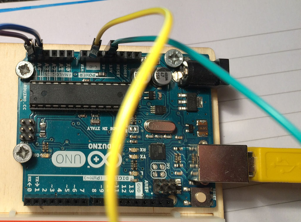

I've soldered on the backpack, and ensured that the correct pins are connected to the I2C pins (A4 to SDA and A5 to SCL in my case for my Arduino Uno). VCC is connected to 5V and GND to ground.

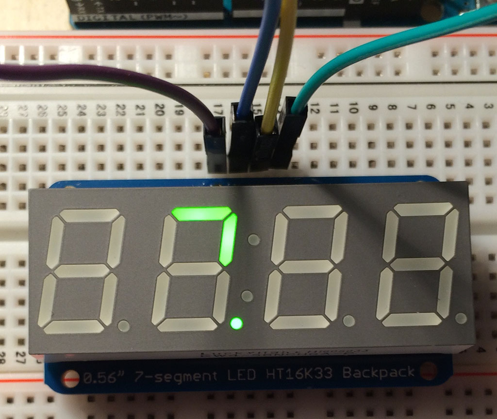

I installed the Adafruit LED backpack and GFX libraries and tried running their test sketch (Adafruit_LED_Backpack/sevenseg.ino at master · adafruit/Adafruit_LED_Backpack · GitHub) but only 4 segments and one dot (all on the second digit) ever light up. I've also tried my own sketch and I can't get any other segments to light up. I've tried re-soldering and I'm fairly happy that I don't have any bad joints.

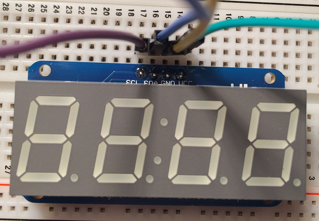

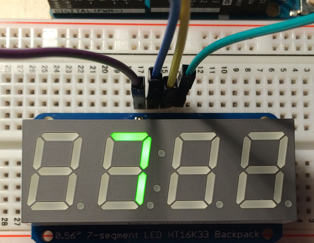

Photos attached of my wiring, and also the resulting segments that light up when running the test sketch here (unmodified):
Thanks, something to work on.
I notice that you have no pull up resistors on the I2C lines. I would put a 4K7 resistor from A4 to 5V and another between A5 and 5V.
Next try a 0.1uF ceramic capacitor between the 5V and ground, up close to the module.
If that does not fix it then maybe your seven segment module is broken or the wiring is intermittent.
Thanks for the advice, unfortunately I still get the same result. I've also tried replacing all the wires just in case, but no joy.
Looks like the 7 seg might be faulty then. I'll try another one and if that's fine with the same setup then I'll know for sure!
OK, not sure why I'm admitting this. But in case this helps future newbies such as myself...
I have just realised that the backpack was soldered on back-to-front.
You nailed it.
