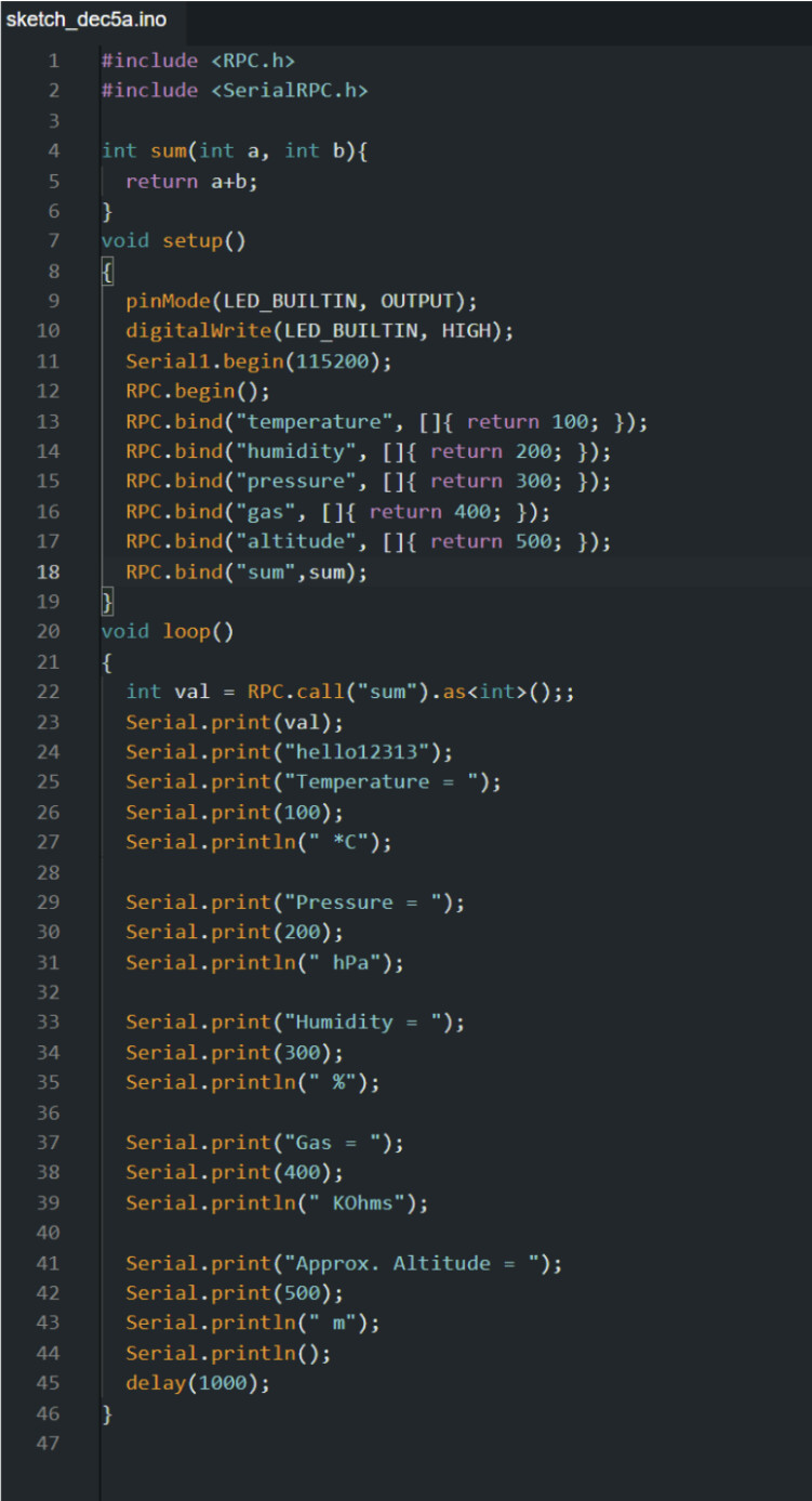

-> Flashed M4 with a script consisting of an “SUM” function to add the variables provided by Linux side.
-> The Basic_AddSub.ino script (link) was referred to bind the functions on RPC by M4, and on Linux side bench_client.py (link) was referred to call the bounded “SUM” function to transfer the data variables.
Fig : Script for binding “SUM” function on M4 (link)

-> Was expecting the integers 1 and 2 that were transferred from linux using the “sum” function to be available on M4.
Actual Outcome :
-> The python script was not working , an error came while using rpc_client.call(“sum”,1,2) indicating the connection is closed but the M4 service is running and all the data transfer works from M4-> Linux.
Fig: Error received on executing the python script to call the function “SUM”
