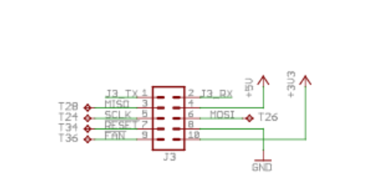

Is it a 2x3 6-pin header? That suggests an ISP programming header.
That guide would only work if it has a bootloader and the autoreset circuit. The fact that it does not work (and that resp=0x00, not other random values) strongly suggests that it is lacking one of those two things.
The autoreset circuit is a connection between one pin of the serial adapter chip on the board, to a pin on the atmega1284p - if it is there (and there wasn't a jumper to enable/disable it) the only way you'd know it is by examining the board to see if the DTR pin of the serial chip is connected to anything.
5x2 header can also be an ICSP header.

While investigating why this would fail, I found a schematic of the board I am trying to get the bootloader onto on Github. Attached is the pinout of the J3 array I thought would be used for the ISP.
This does not match the ISP 10 pin pinout. This makes it seem the board cannot be reprogrammed, but this must be impossible, otherwise, there would be nothing on it as is...
What am I missing?
I've just made another attempt this time using jumpers into my ribbon cable to try and get the relevant pins to match, and it didn't work. I was given this error message:

Do you have a 10 uF capacitor connected between the reset and ground pins on the board you're using as an Arduino as ISP?
No, I don't. Re-reading the guide, I now realize I will need it because my Arduino as ISP is an Uno.
Another thing I didn't do was connect 5v to 5v or ground to ground, because the board I'm trying to burn the boot loader to can only he sufficiently powered by its power supply.
It's fine to not connect 5 V on the Arduino as ISP to 5 V on the target board if the target board is powered separately. However, you absolutely do need to connect the grounds.
