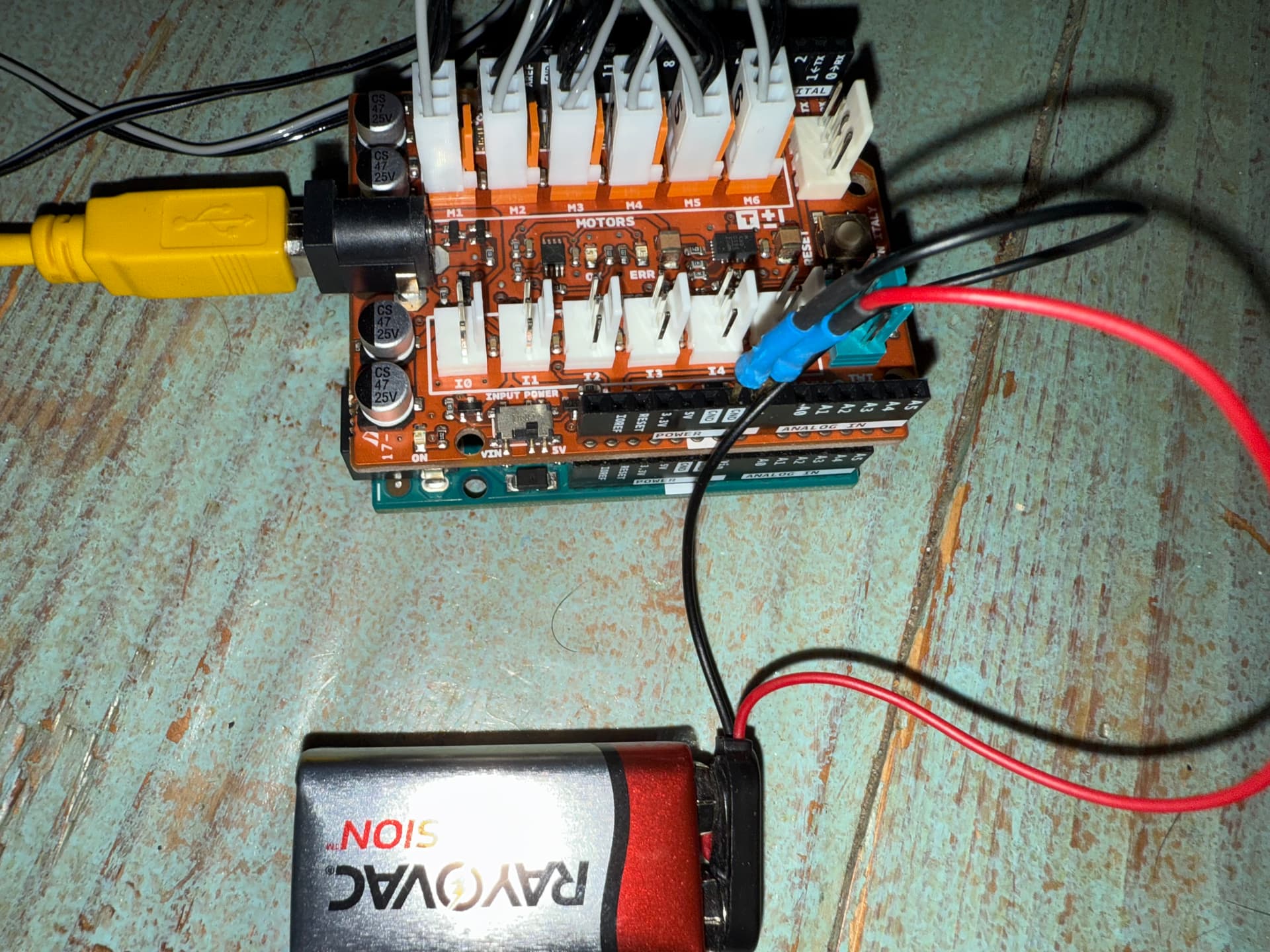

I found the sketch below which uploads, however the robot is completely unresponsive:

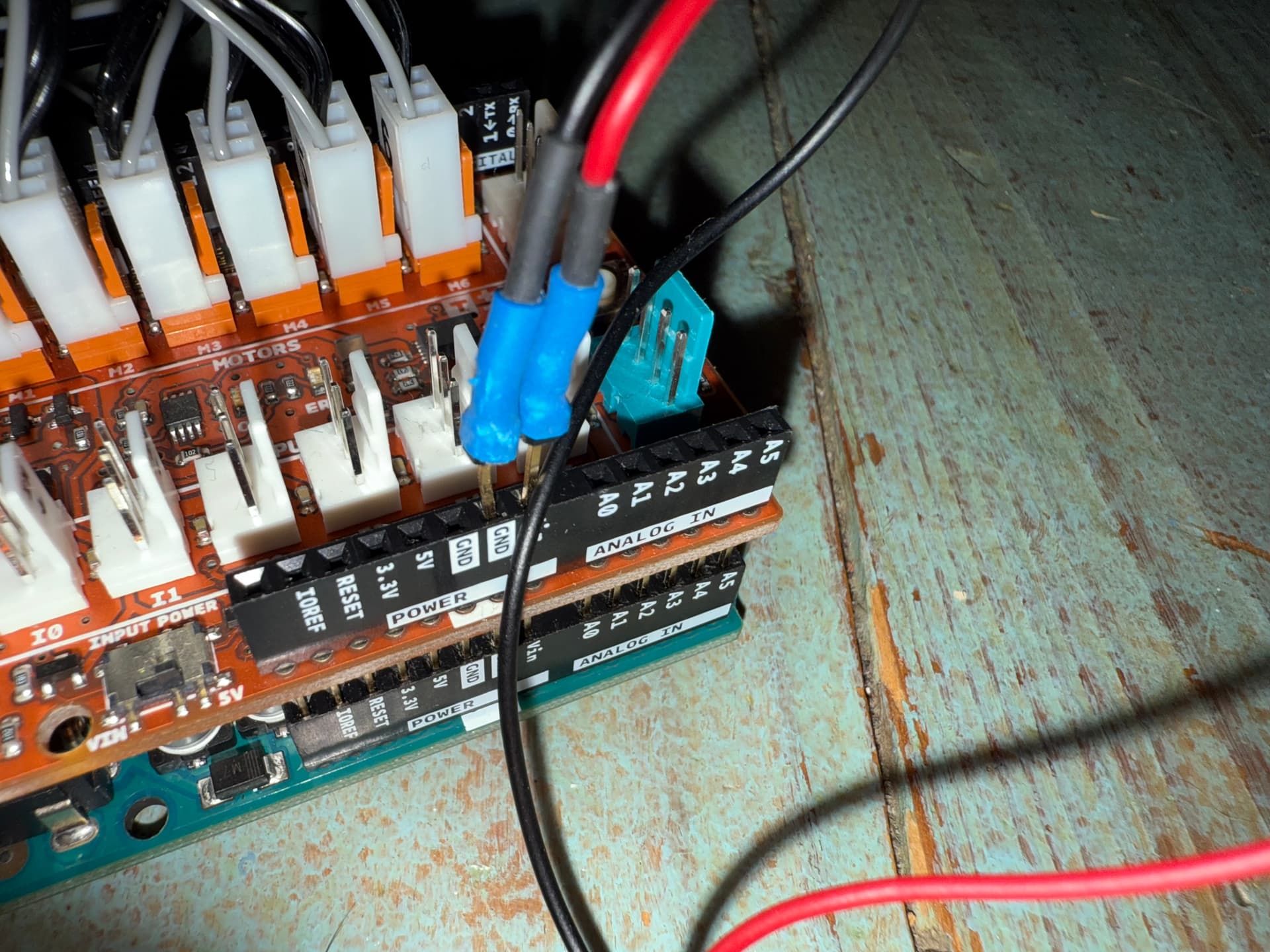

Probably your power and wiring. Show a wiring diagram... i see no pins defined.

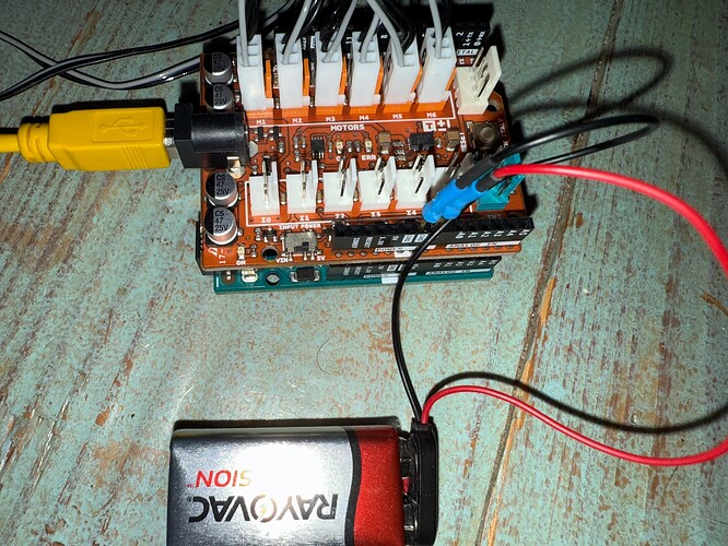

I have a 9V battery connected to Vin and GND and servos connected to the shield:
That battery can't supply high current, sufficient for motors.
If you want support here, post details about your devices/circuit. Some quick google research for "Tinkerkit Braccio" gives 5V5A supply...
I see you have the Braccio motor shield. That has pre-defined pins. Wiring is good. Power is bad.
When a 12V adapter is plugged into the Arduino shield a red LED with the label "error" is turned on. Is it possible I damaged the shield from not supplying enough current before?
What power supply is recommended by Braccio?
No.
But I'm not familiar with your board so you could post some scheme how everything is wired/powered.
In its original form, it is an expensive kit. I can not imagine it ships with a PP3.
