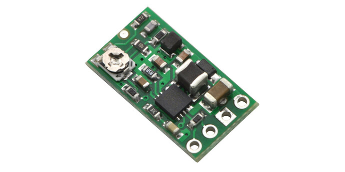

Use a boost regulator like this one to get higher voltage and the 140mA per digit that is needed.
input voltage: 1.5 V to 16 V
output adjustable from 4 V to 25 V
2 A switch (and input) limit

This one might be all you need even for a couple dollars less
Pololu Adjustable Boost Regulator 4-25V
Pololu Adjustable Step-Up/Step-Down Voltage Regulator S8V3A

CR, I was looking at using a booster indeed. I'm going to have a 12 volt regulator to bring down the ~18VDC transient spikes (14.8RMS) in the electrical system, so I figured I can use a 12->17.5V booster. The 5 volt regulator is rated for a 25Vin and only will be powering the 328 and shift registers so it should be fine with the extra power dissipation.
The 12V LDO is on a small 8.5C/W heatsink in a vented enclosure (possibly with a 60mm computer fan) so up to 2 amps in 120 degree texas heat shouldn't be a problem on a 19 Vmax system (IE,a 16 volt system with similar transients).
So normally it's Vin-> 12V LDO -> 5V LDO
on custom boards, it'll be Vin -> 12V LDO -> pololu board -> 5V LDO.

I've been looking for a 2A boost IC that works down to 3V (to drive LED matrix displays) I looked at the link, but there is no technical info about that board...do you know what Boost IC they're using?
Nope, can't tell what it is. Will see if I can read anything on my board tomorrow.
