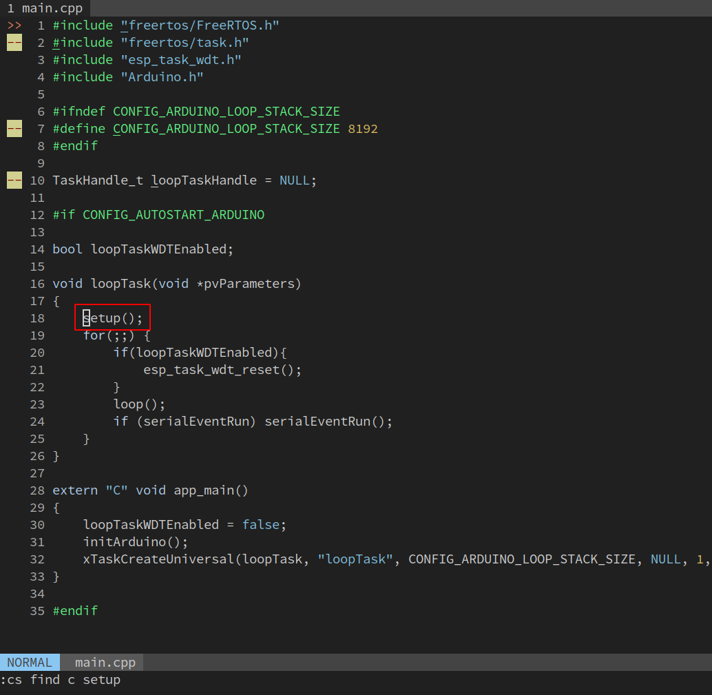

Use case #1: Finding How setup() and loop() is Called in ESP32
The story about how setup() and loop() is called in ESP32
  1. After the database of cross-reference is loaded, we can use :cs find c setup in vim to search where is the setup() function be called.
  2. We can clearly see that setup() and loop() are called in a FreeRTOS task in ESP32. Which is greatly different from what ArduinoCore-avr does.
