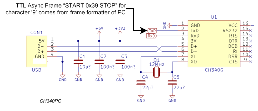

USB has no Rx/Tx UART signals. A (TTL) UART is not well suited for communication with other devices, so a couple of converters (RS-232, RS-485, MODBUS, current loop...) exist for that purpose. A USB-UART converter already sits on your UNO, so you can use it with any terminal or other program as a serial port on your PC.
Hope that the following description will help you to understand that the just direct connections of D+ and D- pins of the USB Port of PC with two pins (say: 10, 11) of Arduino UNO will not help for data exchange between PC and UNO.
1. USB Port of PC
There are two data pins: D+ and D-; one pin for 5V; one pin for GND (Fig-2).
2. Assume that you want to transfer a 10-bit asynchronous frame for charcater '9' (Fig-1) from PC using its USB Port to Arduino UNO. The following events occur:
Figure-1:
(1) The TTL format of the async signal (Fig-1) enters into a "TTL async to USB async" converter (an elctronics module similar to U1 of Fig-2 located on the Motherboard of PC) to produce D+ and D- signals (Fig-1) which appear on the physical D+ and D- pins of the USB Port (Fig-2). The differential format of D+ and D- is known as Manchester Encoding (USB Format). You can read literatures to know the advantages of Manchester Encoding. The signal can travel upto 25 meters (82 meters) and is extensively used in Local Area Network.
Figure-2:
(2) At the Receiver Side (the UNO), naturally the same arranagement as in Fig-2 should be engaged to retrieve the original TTL format from the incomging USB format from the RXD-pin of U1.
3. In Fig-3, we can observe the existence of USB <----->TTL Converter chip (CH340G).
Figure-3:
Note: It would be possible to make a direct connection of the TX/RX pin (carries TTL async frame from hardware UART Port) of UNO with the PC should the formatter output of the PC (Fig-2) be available at a rear connector of the PC. Any other two pins of UNO could have been connected, then those two signals must carry TTL async frame from a Software UART Port of UNO.
Thank you very much, this answer is the one I couldn't find, I thought that usb also transmits data in TTL, I see that its electrical characteristics are different. Thank you very much for your answer, it has really clarified me a lot.
Ok, maybe I can make a small program/driver that recognizes the arduino port and transforms it into a virtual joystick device, then it would only be to read the serial data. I saw that with python I can do it.
I replyed the last in spanish lol
The only detail would be that the arduino port should be a HID device like a joystick.
Then yes, out the box, uno and mega wouldn't cut it..
Arduino Joystick Lib Supported Boards..
You could make it work, HoodLoader2..
But seems like allot of trouble..
Maybe an esp32s3 dev kit..
Has 2 usb ports on it, one uart the other can be hid I believe..
ESP32 Joystick Lib..
cheaper, faster and don't have to hack it..
