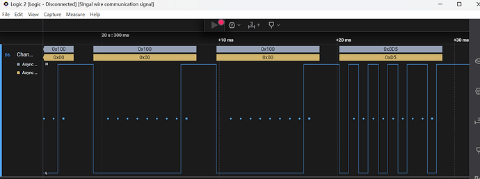

Hi there, i am working on a reverse engineering project . My problem is that, i have a device that commnicates via signal wire . I have found out that it is UART signal and also found a baudrate manually(1200 bps ). Now the problem is i cannot figure out the frame format of the commnication. I have captured the signal in saleac logic analyser and used the in-buit UART protocal analyser but 2 configartion mathes the signal without any framing error, or parity error.So i dont know which is the proper configuration.
Configuration:
Baudrate = 1200bps
  1. Startbit + 8bit data + odd parity + 1 or 1.5 or 2 stop bits
  2. Startbit + 9bit data + even parity + 1 or 1.5 or 2 stop bits
i have attached the logic analyser files here below:
Can anyone help me out understand the frame format. thank you. :grinning:

But as per the single transition representing "1". The time of high transition 832 microseconds and the formula to find baudrate is 1/time of single transition. So i decided that it must be 1200bps. But if u have any new approch i am ready to study further. thank you

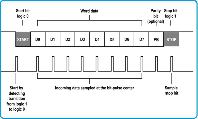

This is how UART transmitted data is organized: It is organized into packets that have one start bit, 5 to 9 data bits. A parity bit is optional, and 2 stop bits.
Start Bit: When not transmitting data the UART data transmission line is usually high voltage. In order to start the transfer process the transmitting UART switches from high voltage to low voltage for one clock cycle. The receiving UART will detect the high to low voltage transition and start reading the bits at the accurate baud rate. Note many of the serial line drivers reverse the polarity as they are inverting.
Parity: Parity is the oddness or evenness of a number. The parity bit functions to tell the receiving UART if the data has changed during transmission. Bits can change due to electromagnetism, different baud rates or long-distance transmission of data. The UART reads the data frame after receiving the data. It then counts the number of bits and checks if they are even or odd. If the parity bit is a 0 then it is even parity. If the bit is a 1 then it is an odd parity. For the UART to know that the transmission is free of errors the parity bit has to match the data. You can also transmit without the parity bit.
Stop bits: For at least two-bit duration the transmitting UART drives the transmission line from a low to a high voltage. I always sent with two stops bits and received with 1, this gave me one extra bit time to minimize data skewing.
Baud Rate: The communication between two devices via UART Protocol occurs by transmission of bits. A total of 8 bits are sent one right after the other to transmit a byte. A bit is either a logical low or high. The time interval between two bits is called the baud rate or bit rate. The baud rate must be defined in both transmit and receive devices. This allows the sending device to encode the data into bit pattern with the specific time interval. There is an allowable tolerance in the baud clock. Note the faster the baud the narrow the time tolerance becomes. It is important that the receiver gets the successive bits at the right time.

Without documentation a single transition may represent two adjacent "1" or perhaps 3 or even 4.
This image is of first 4 transimisson

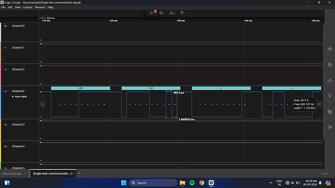

This image is of the full 20 transimision
Hope it is clear enalf :smiley:

But how do I confirm which configuration is the correct for the frame I am working.
You can try several ways of decoding it. My preference is to use a logic analyzer. There are some very inexpensive ones out of china.

Can you measure the time between adjacent start bits?
For the 2nd possibility, is the parity bit always the same level as the stop bits? If so, then the first option is likely the correct choice.
been playing with the .sal file and I got
  1. Startbit + 8bit data + odd parity (same as you! :slight_smile: )
    for a baudrate =1200bps
the stopbit IMHO is irrelevant in the sense that setting stopbit=1, you can insert a delay between transmissions if required.
my money is on option 1...

I agree with @sherzaad - pick one of the settings, and see if you get errors.
Unless the original hardware does multidrop, the 8bit format is more likely.
The correct frame format for the signal is
Start bit+8 bit data+odd parity+1stopbit
