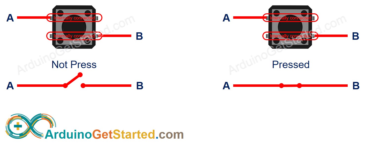

The switch in the attached example is wired as S3 below:

Excellent switch graphic. Hadn’t known about the relative merits of the basic configuration options. Think I’ll have to change my habitual default of always choosing high-when-pressed.
BTW, Is there an equivalent diagram for NC buttons?

It would be the same drawing, the switches would just be normally closed.
A LOW would be switch RELEASED
A HIGH would be switch PUSHED
