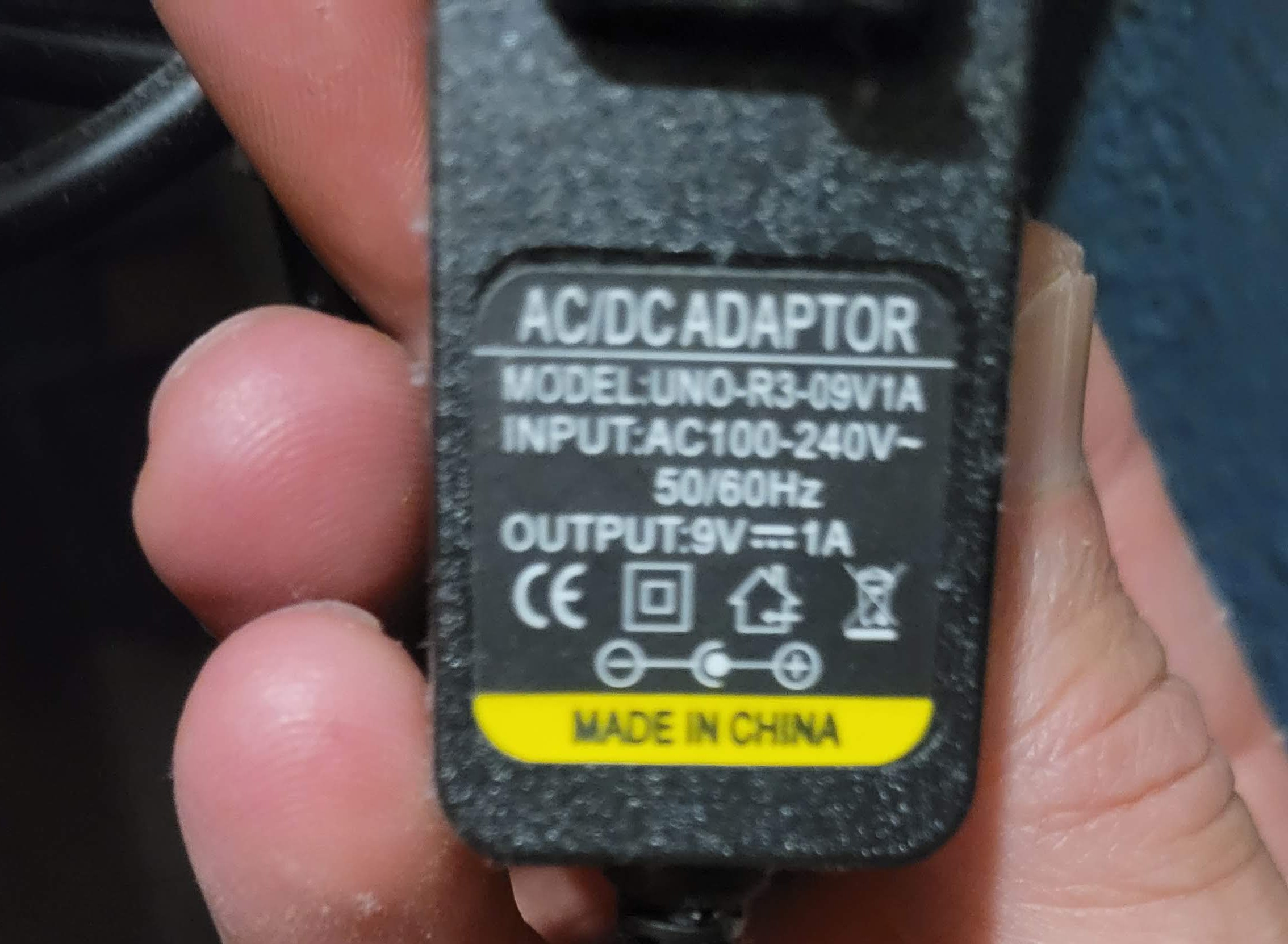

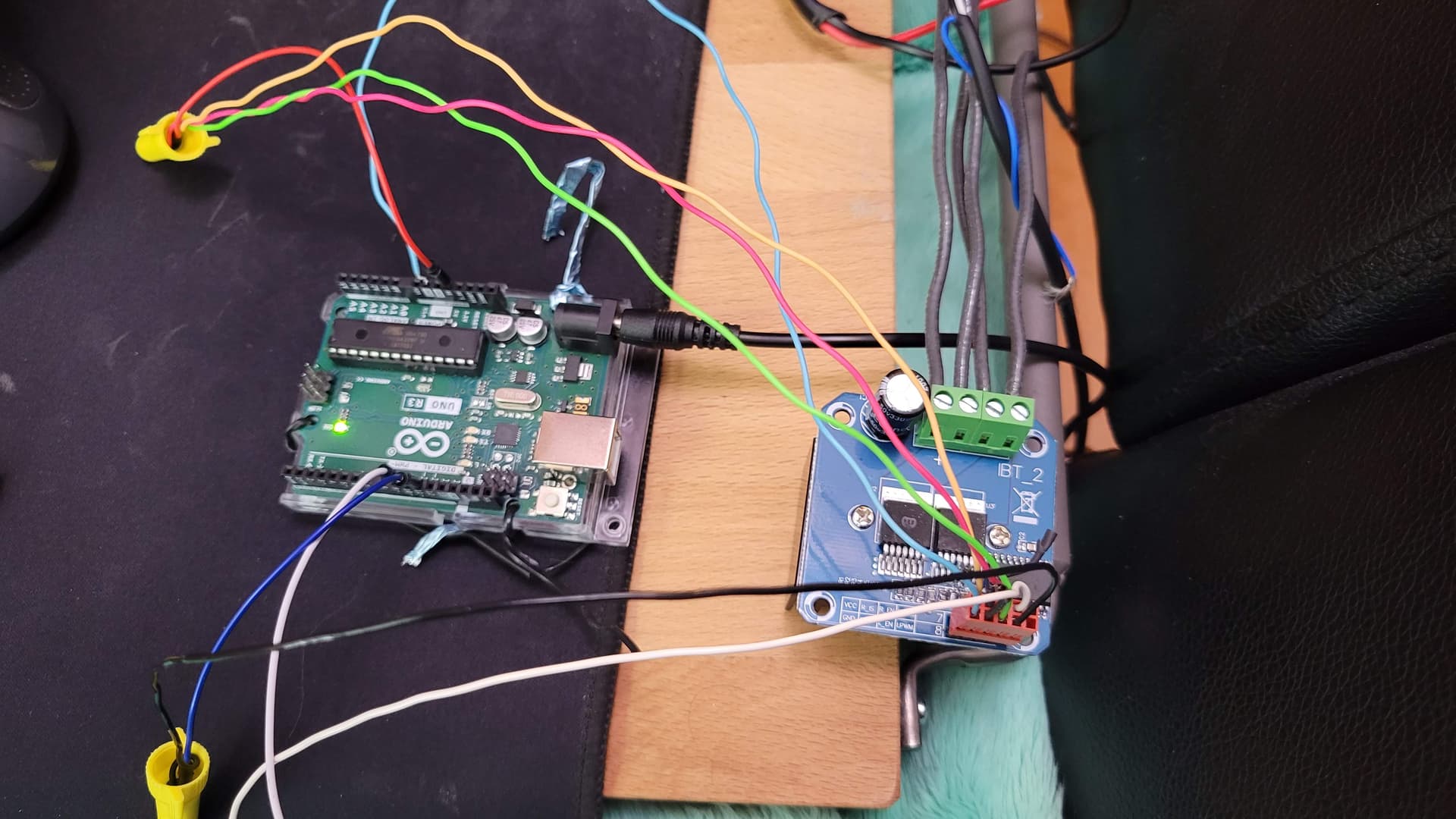

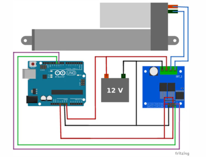

Which Arduino are you using?
How is everything powered?
How is the actuator controlled?
Are all connections soldered?

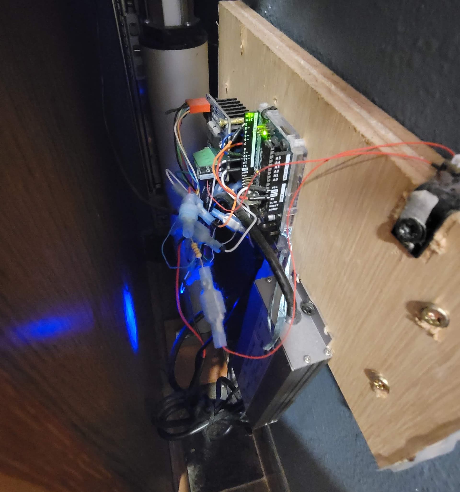

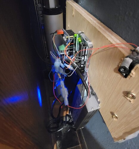

Is this device indoors?
Since the problem is probably not in your code, it would be a good idea to post a photo of your setup.

I moved the setup location a little over a year ago and this has happened 5 times in 13 months. If I leave it to continue, the actuator cycling does get more frequent. I left it for a couple of weeks and by the end it was cycling almost constantly, with sporadic breaks. Also, power cycling does not fix the problem immediately but unplugging for an extend duration does. I need to let it sit for more than 15 min to get it to reset. I'm currently one week in from the last reset with exactly zero false triggers.
Including my workbench setup (it is currently installed deep in the back of a cabinet so photos will not be possible.
Button function video (before sound insulation)
Thanks again, your combined responses have blown me away.
Where are your pullup resistors?
  • Please provide us with a proper schematic showing all the component connections.
This certainly contributes to the problem. But there’s more to it: the connectors highlighted in the image are absolutely not suitable in the long term.
How is the Uno powered?
12V?
What current?
Do you have power outages or AC power problems at your location?
Is everything inside an enclosed space without air flow that could get hot?
Code uses built in pull-up, I'm assuming that this works rather than including an extra resistor.
pinMode(buttonPin, INPUT_PULLUP); // Configure button as Input
Using the official Uno 9v power supply at 1A

Area is mostly enclosed but I provided a 3" x 6" opening (top and bottom) for airflow. I live in the PNW and temps in the house stay cool year round. Heat is not an issue.
While I know that this is not suitable I did install my test setup (embarrassed to admit). This is the weakest part of the whole project and I need to fix it. What is the ideal connection method I can use to replace this?

Here is the full schematic along with the actual setup.
