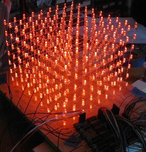

Here's a couple pics of it working.
Well, looks like I just have the 1.
Nice CrossRoad :smiley: :D!
