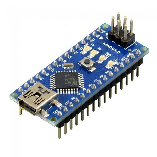

I have the above code and using the below MC.
However XLAT_PIN and BLANK_PIN etc are undefined.
If the MC is not a Mini, Micros, Nano or Pro then what is it?
I don't suppose there is a preprocessor trick to get a dump of all the active defines?
