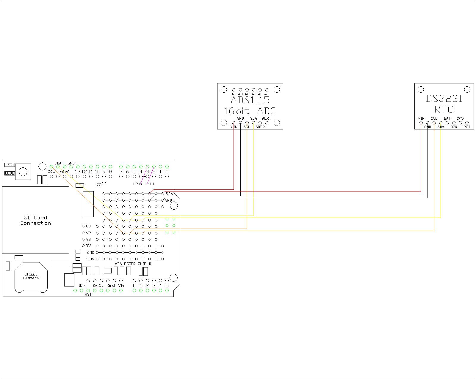

Hello. Over the last few months I have been developing a datalogger. The datalogger consists of four main components:

As you can see, I tried to implement debugging methods into the code wherever possible. I am new to coding, so I will take any advice given.
I have been running into an error over the past several times using the data logger. The datalogger will successfully start and run for hours at a time, even multiple days at the beginning. However, after a while, the datalogger will simply stop executing the code. The first couple of times using the datalogger, it ran for days on end, successfully writing data. However, after the third day when I checked on it, the datalogger would be sitting there idle showing no error codes. Most recently, the datalogger will only run for a couple of hours before it stops executing the code and sits there idle.
During my most recent datalogging session, it ran for just over 2 hours and 10 minutes. I had it connected to my laptop so that I can record the log through the Arduino serial monitor. It ran successfully, until something happened. It stopped writing the date and time, but still wrote the voltages and temperatures. Then after about 2 minutes, it stopped working completely. Here is the data I got from this most recent session:

Yet another possibility is electrical noise in the power supply. Please post a wiring diagram (hand drawn is fine.).
I will look into it. Give me some time to come up with a solution please.
Thanks for everything.
Datalogger Wiring Diagram-Layout1.pdf (47.5 KB)
Ignore the second ADC, I never wired that in yet. Also, ignore all of the wiring to the terminal blocks, as I no longer have it connected to those. Lastly, ignore the fact that I have an Arduino Uno R3 drawn, I am currently using the Mega 2560.
The PDF does not download very quickly. Here is a JPG. This also more accurately describes what the current setup is. The PDF I showed was my own drawing I used originally when I was first coming up with the Idea. In this JPG, you can see how I have my ADC and RTC wired into my SD Card Shield. I use the prototyping portion of the SD Card Shield to connect both the ADC and RTC to the SCL and SDA pins. The SD Card Shield plugs directly into my Arduino Mega 2560. I have Pins 2 and 3 being used for LED 1 and 2.
