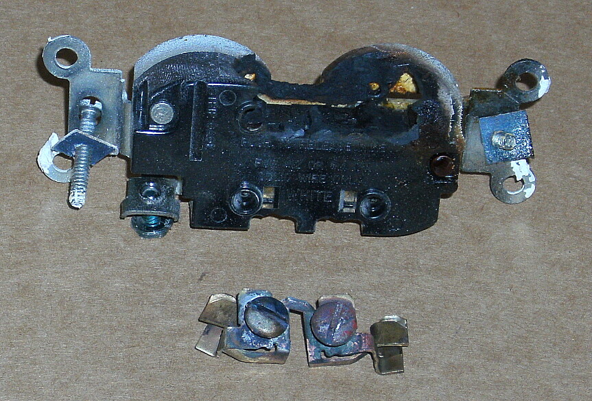

That doesn't answer the conjecture I posed. Thermal shutdown is some sort of internal
process, and takes a certain amount of time, and may be overshadowed by other
circumstances. To give an example, sometimes things burn up before circuit breakers act.
Here is a picture of the 120VAC outlet which was feeding the microwave oven [installed
by the previous owner, I luckily smelled the "smoke" in time],
