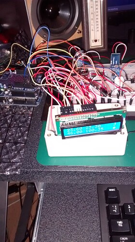

new to the forum here. Absolutely loving arduino and IoT related stuff. I'm new to electronics but have a fairly strong background in programming.

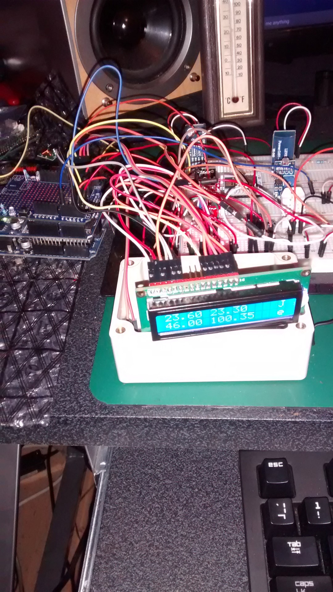

I would like to ask if my current plan is feasible:
As you can see from the picture I have an UNO with an internet shield on top. I am aware that D10-D13 are used by the ethernet and that my current LCD uses like 7 pins. After hooking up an RGB to A0-A3 and a DHT22 to the other 2 analog pins that is me completely out of GPIO's.
While this is fine with the little 16x2 LCD I would love to get a better one, perhaps a larger touch panel that seem to be real cheap on ebay.... are there any decent ones that don't require so many digital pins so I can free up some space?
oh P.S. I also want to attach an ESP8266... I think I read they consume D0-D1(tx-rx) right? so I'm safe there if that is the case
Very new to all this so any input would be extremely appreciated and I will be happy to release code to any other newbies once it is all nice and working.
For starters you can get an LCD with i2C backpack. It needs 2 GPIO pins viz A4 (SDA) & A5 (SCL).
If u keep adding hardware and plan on using the SD Card on the Ethernet shield as well, be prepared to start looking at a Mega for additional flash/sram memory.
I Went ahead and purchased a 320x240 SPI LCD. It appears to only require 5 digital IO's should should work nicely for my scenario.
I actually already have a DUE which is getting used for the main project, this uno is simply the "receiver" via ethernet / esp8266 wifi.
I will probably be back to the forum soon complaining about struggling to get the esp8266 working haha just waiting on some 3.3 voltage regulators coming on the slow boat so I can get that hooked up. a simple resistor setup I assume would not work to drop the tx & rx to 3.3?
Still need to read up on the esp8266 to be honest so I will go ahead and do that now

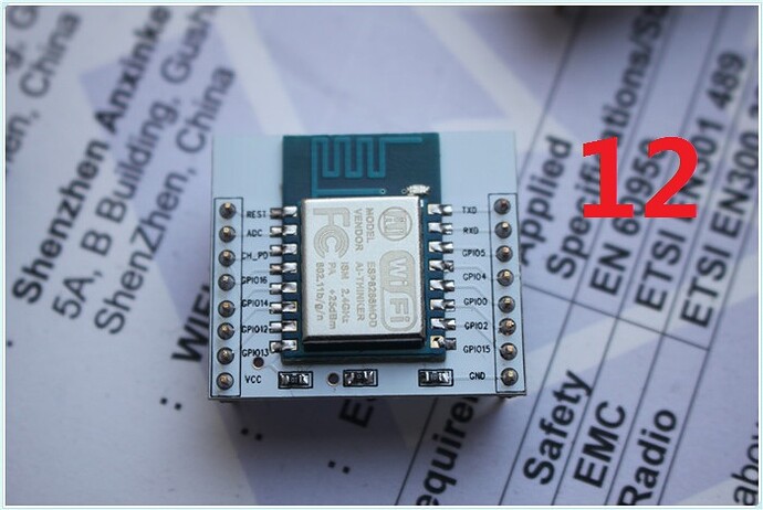

I am not sure which ESP8266 you are using, there are a variety of them.
The ESP8266 chip requires quite a bit of power and the Arduino does not have enough oomph to drive it.
You need to check the data sheet for the rating of your specific module.
For the I/O pins resistors can be used in series, but you can also use a level shifter.

The module is a ESP8266-12... I have already soldered it to the breakout board so fingers crossed it works when I get my 3.3v regulators.
I'm sure I have seen video's where people ran the module directly from an arduino, isn't the 0.5A draw from a USB port enough for the arduino and module combined?
If I do need an external power source how do you recommend I wire it all up so I don't have to use multiple plugs? When the project is complete the arduino will be powered via the 5v adapter socket.

I am testing an ESP8266 module on an iBoardex. The board runs much hotter with the module than without - I am still investigating.
I appreciate the help, thank you.
I didn't intend on blindly following others but as much input as possible to my newbie electronic mind is likely advantageous. I was already aware that the ESP2866 consumed 200ma but was under the impression that the arduino could support that. Obviously I have further research to do, but it is early days as I only just got into electronics recently.
Maybe a silly question, but you mention that it also comes down to pin ratings other than current draw. I have seen many video's of people using these modules with arduino uno's so how do they manage it if the UNO pin's are not compatible?

Thanks, I understand now after reading the links that you provided. I was unaware that the logic levels on the UNO would be up to 5v and also that the arduino provided so little current.
My current conundrum is getting both an (SPI) Ethernet Shield & (SPI) LCD to function together on this UNO, if it is even possible. I am looking into software SPI for the LCD as I won't really have to refresh very quickly but was wondering if Chip Select would work to alternate between devices?
And in relation to the ESP8266 would a 3.3v regulator (AMS1117) in line with large capacitors do the trick in order to be powered directly from an arduino with a 5V/2A DC power supply (on a DUE)?

The AMS1117 will work fine I have two boards with them On them works great
If I understand u correctly, then IMHO no - not a good idea.
The AMS1117 can be used to supply power to the ESP8266 directly i.e. not via the Arduino.
For the logic levels, you would normally use a shift register (e.g. 74HC595) to change voltages.
Doesn't the breakout board you have now, have on-board voltage shifting?
Usually breakout boards or adapters will provide the necessary shifting - u need to check the datasheet.

Why not just power the ESP8266 direct from the 3.3V pin? - it can supply 800mA.
Also the DUE I/O voltage level is 3.3V, so you don't need any shifting.

He's talking about the 5 volt pin On the due
Well actually ideally, I would like to get an ESP2866 working on both my UNO and DUE if possible but it's more important that I get it working on the DUE which of course is 3.3v power and 3.3v logic levels which should be fine without any voltage dividers, right?
And in relation to the power draw for the ESP2866 I read that a capacitor is required to hold some power required on TX bursts to prevent drop outs. You say you don't recommend this, may I ask why? Just trying to get a clearer picture in my head of how this is all going to work.

I think you misread my reply. My "not good idea" was in relation to powering the ESP8266 via the Arduino (I assumed Uno). Caps are used for a "quick discharge" power boost - which is sometimes needed. They are not essential but will improve operation such that you will probably have less loss of packets. So by all means add it - make sure you get the polarity right if u use a polarized one.
