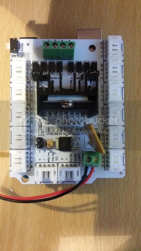

Have a real issue I'm struggling with here and could really do with some help with it! I'm very new to both electronic bits and programming, but certainly getting there already. I am trying to create a set of "presets " for moving a geared dc motor within the same sketch, which will then be able to be selected via an LCD and it's buttons.
The issue I'm having is twofold. First, getting the linksprite motor shield to work alongside a linksprite 16x2 LCD. Both codes work on each item respectively, such as the menu system on the LCD and the motor control. But I physically cannot get the motor shield, LCD and uno linked up, let alone the codes written to work together. I think the issue may be with the puns, but from memory (at work atm so notes not to hand) there are a few pins spare but can't work out how to change them (if that's even possible)

Your display uses: 8, 13, 9, 4, 5, 6, 7 for the lcd and A0 for the buttons.
Your motor shield uses: 3, 4, 5, 6, 7, 8, 9, 10, 11, 12 (pin 9 and 10 only for the servo connectors).
So it is impossible to combine those.
You could rewire everything on the lcd shield to make it work.
The motor shield does not use pin 2 and 13 and also not A0 to A5. So it is possible to make them both work on the same Arduino board...

That one uses digital pin 8, 9, 10, 11, 12, 13.
So you can cut traces on your LCD shield. Cut the traces to pin 8, 9, 13 and use wires to other pins. For examples A1, A2, A3.
Or you can bend the pins of the motor shield. Also pin 8, 9, 13. After the bending, connect 8, 9, 13 of the motor shield to unused pins, that might also be A1, A2, A3. And adapt the sketch to use those new pins.
Here is a photo of bending pins : http://mcukits.com/2009/04/06/arduino-ethernet-shield-mega-hack/ (scroll down a little).
You could also cut those pins, or use a solder iron to remove them.

Can you make a photo of it, before turning the power on ?
Bending the LCD pins doesn't help, the shared pins (8,9,13) of the motor shield will still be conntected to those pins on LCD shield.
There is more confusion: In the example sketch, they use pin 13 for RW to the LCD. However, in the schematic pin 13 is not used, RW is tied to GND, and pin 10 is used to turn the backlight on and off with a transistor Q1.
So it might be that 8,9,13 are shared with the two shield, but it might also be 8,9,10.
Since I see a transistor Q1 on the photo, I think that the example sketch is old, and the schematic and photo are new. So I think now that is 8,9,10 that are shared.
Do you have a multimeter ?
Since pin 8 and 9 go directly to RS and E of the LCD display, you can remove the connection from the LCD module to the pcd board of the shield. Remove those short pieces of wire and solder a new wire from the RS and E on the LCD module to the new pins on the shield.
Use a multimeter to check if you need to change pin 10 or 13 (or both).
For pin 10, do you see R7 and R8 somewhere on the LCD shield ? They make the backlight turn on, but are also connected to D10.

With the Shields connected as discussed last night I'm only getting one led on the motor shield light up, which I think from memory was the vlogic green led. There is a red led under in2 I think, when the shield is actually running and rigged correctly.
Here is some pictures of the motor shield. The lit LED one shows how they light up when powered and working correctly
