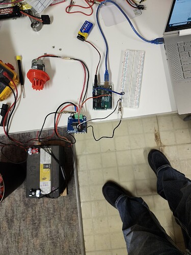

Hello,
I was following DronBot Workshop's video on motor controllers as a guide. However my motor doesn't turn on. I tried searching here and found that sharing a gnd between the battery, IBT_2 board and UNO was missing. So I added that and still nothing. I kept searching and everything i found said this setup should work(see schematic below). The one thing I thought about was that the led on the uno doesn't lite up, so I hooked up a 9V battery to power it and now they lite up; but the motor still doesn't spin. I've tried a couple of different code examples, which primarily swap PWM ports on the UNO but otherwise are the same. Anyway I've seen that people like to see a schematic, a picture of the setup, and the code. Can you see what I'm doing wrong?

@gilshultz@Railroader Ok. I switched power of the arduino and the IBT2 to the battery as well. I checked voltage at the arduino bullet connector (12V) & checked voltage at the IBT2 and am getting 12V to that as well. I have an updated wiring schematic below. However the motor still doesn't turn on. Do you have any ideas?
If You disconnect pin 9 and 10, what voltage do You measure at the driver pins RPWM reså. LPWM? ( I don't know that driver by heart.) Measure the voltage from GND and to the pins.
Check the eventual straps on the driver.
From the frizzy picture missing almost of the details I will take a SWAG and say it is not properly wired. Take a look at this link and see if it helps: IBT-2 H-Bridge with Arduino – Dr Rainer Hessmer
@Railroader When testing the voltage at the rpwm & lpwm I got 0.0V at each pin. I reconnected rpwm & lpwm and checked voltage at the pins and got 1.88V at each. I was expecting that when the microcontroller is running and sending pwm that the voltage would increase and decrease or would be really sporatic because a fluke volt meter can read pwm signals. So a constant voltage seems weird to me. What do you think?

Ah, I meant to say "a fluke meter can't read pwm signals". Just trying to convey that i understand i don't have the right equipment to read the values. I measured voltage at the motor outputs and i got the 12.5V at M+ & M-. It didn't pulse either.
I connected the Neg Probe of my DVM to the battery and poke the motor connections. I got 12V at both the + & -. I thought only one side would have a voltage difference. So I changed the code for testing purposes as below. This should just cycle the motor on/off every second.
Checking voltage at the pins on the IBT2. The motor + & - had 12V. The enable pins were going back and forth between 3V & 0. This was not expected since the code set them to high. The LPWM & RPWM were cycling back and forth as expected. Why is the arduino cycling the enable pins?
Update:
That last scenario was when the arduino was plugged into the computer. When I unplugged it, and plugged the bullet from the battery in some things changed. The enable pins are now holding steady @ 4.5V. The PWM pins were cycling between 4.5V & 0. The Motor + & - both still said 12V. Ahh, an amateur like me doesn't know what to make of all of this inconsistency.
Sooo, i figured it out. It has everything to do with being a rookie. I beleive that i was in overvoltage lockout because i had the vcc & gnd (ibt2) direct from the 12V batt. So i put a buck converter between there and was able to get the motor to spin. @gilshultz@Railroader thanks for the helpful suggestions!
