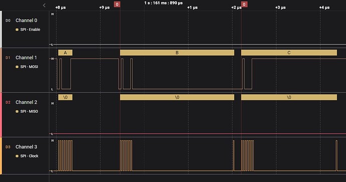

I then ran the following SPI test program on R3 and R4 with the standard SPI library.
#include "SPI.h"
#define CS_PIN 10

Here are results.
Uno R3 byte transfer:
Clock is 8 MHz.
1.75 us/byte or 571 KB/sec
This is what i expected, a fair gap between bytes.
Uno R4 bye transfer:
Clock is 24 MHz.
11.87 us/byte or 84.2 KB/sec
Huge gaps between bytes.
Uno R4 array transfer
Clock is 24 MHz.
2.75 us/byte or 364 KB/sec
Strange clock. The first byte has eight pulses evenly spaced. After the first byte there are seven pulses, a big gap and the final pulse.
I hope Arduino has some fix for the SPI library. This is huge disappointment. The R4 seemed like a great replacement for the R3.
Guess I should post an issue on Github.

@fat16lib
was chatting with one of my team mates and he pointed out that while the AVR SPI directly manipulates registers, for the R4 core we tend to wrap our own API around Renesas FSP.
There is a transfer array, though.

As an aside, a 4 wire 32-bit SPI transfer at 8MHz bit-rate (RA4M1's max slave rate) using SPI1 as a master and SPI0 as a slave takes about 7uS.
That's timed with my inline direct register accessing code - without a function call/return.
The RA4M1's peripheral status signalling etc. seems to have several sets of clock delays in them, testing with pin-state direct high/low writes shows that the status flags take a while to propagate - it's taken me a few days to work the wrinkles out! :slight_smile:
